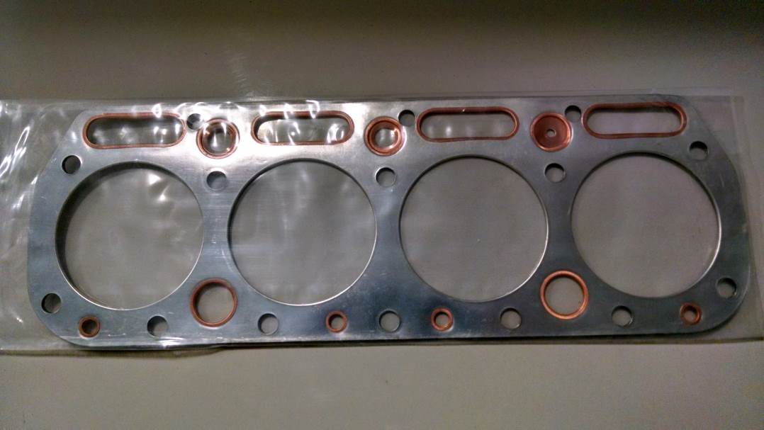

Dan, I had this gasket customed made a few years back after I found out Victor Reinz #3162 gasket was discontinued. Victor Reinz made them for Allis Chalmers. I attached a picture of what the new gasket looks like. Design was copied from an original Allis Chalmers metal gasket with copper water ports and asbestos fiber core. The vendor did not used asbestos in the new gasket. If you interested in purchasing one, I would need $98.00 for gasket plus shipping. I can get a shipping quote once I have your address.
I have used two of these gaskets without having any issues with coolant leaks.
