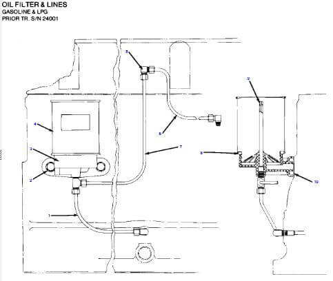

Here a bypass oil system picture from the D17 Parts Manual, prior to serial 24001. This is the same as a WD45

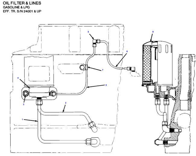

Starting at D17 serial number 24001, Allis changed to a full filtration oiling system. All of the oil is pumped outside of the block and through the remote filter. Part of the filtered oil is pumped up to the rocker arm and governor via a small external line, while the rest is pumped back into the block. The oil then lubricates the bearings as described in the WD45 service manual.

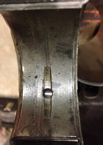

Here is a picture of a WD45 main bearing insert. Unfortunately I don’t have any pictures of a D17 main bearing.
