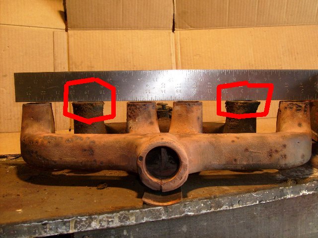

Well, here it is.  The exhaust ports are about 3/32" lower than the intakes.  Guess, I'm gonna do like Brian, and use a file or angle head grinder to make them all the same level.

That erosion... if that's the way it is... isn't so bad.  If I didn't have machine tools, I'd use a belt-sander and just sand it down 'till they're really close... that'll give you better results than an angle grinder... a 'flatter flatness'...

I'd do as Dave suggested. Work them down with a belt sander, and finish them off with a mill file. If you have one of these it would work pretty well.

The reason the intake ports are so far above the exhaust ports (in the pic) is because the steel rings and part of the intake gaskets were still on the manifold.  So.......very little work with a large file made all of them even.  Will fill in a few of the pits with refractory cement, apply new gaskets, and reassemble everything.  Boy, do I feel STUPID! (but relieved, lol).  Thanks for all the info and comments..............O_O
Nothing stupid about that. None of us caught it and I can see it now that you mentioned it. The picture looks like the left exhaust port drops off to the outside edge. That is where they start leaking and eroding. It won't hurt to check or file the side of the head too, looking close at the outside edges to be sure they don't drop off some.
