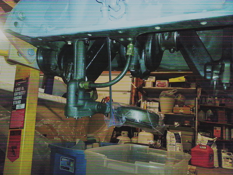

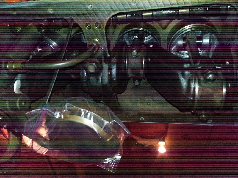

Don engine is already together up and running. It sounds great with the Nelson muffer. I took a pic of the dipstick hitting sump before I put pan on. I'll get it posted on here in a little bit.

Forgot to say in first post. The dipstick would not clear the crankshaft either!

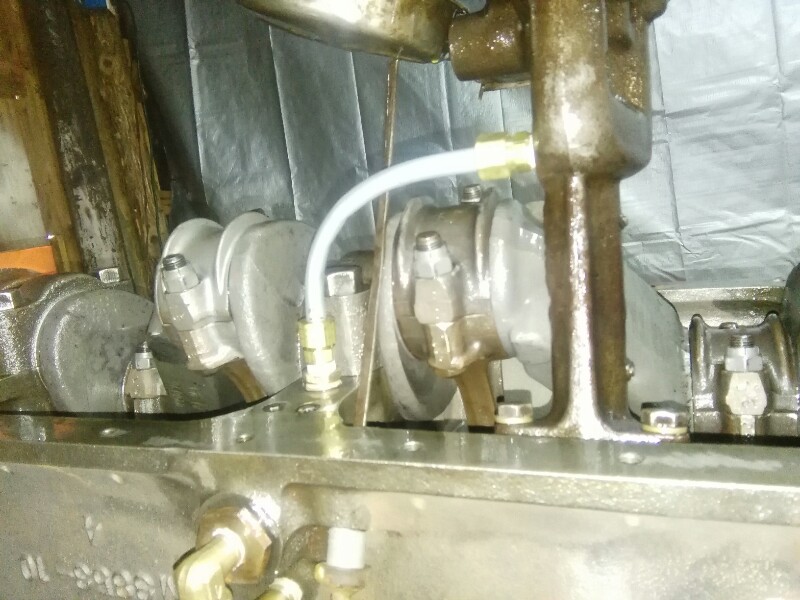

Here's a WD converted to full flow, I did not have to do anything and it fits fine. From the looks of your photo it's bent in toward the middle too far, it should go straight in from the hole then gradually bend back toward the side of the pan after clearing the outlet line. Just bend it back a little bit, no need to change marks if it fits it's right. Sorry about the bag in the way but there is a gap there.

Ill get a pic of what I did to it. I had to bend it quite a bit. It was straight before I messed with it and was hitting oil pickup and crankshaft. The dipstick in the engine I took out is completley straight and doesn't hit anything.

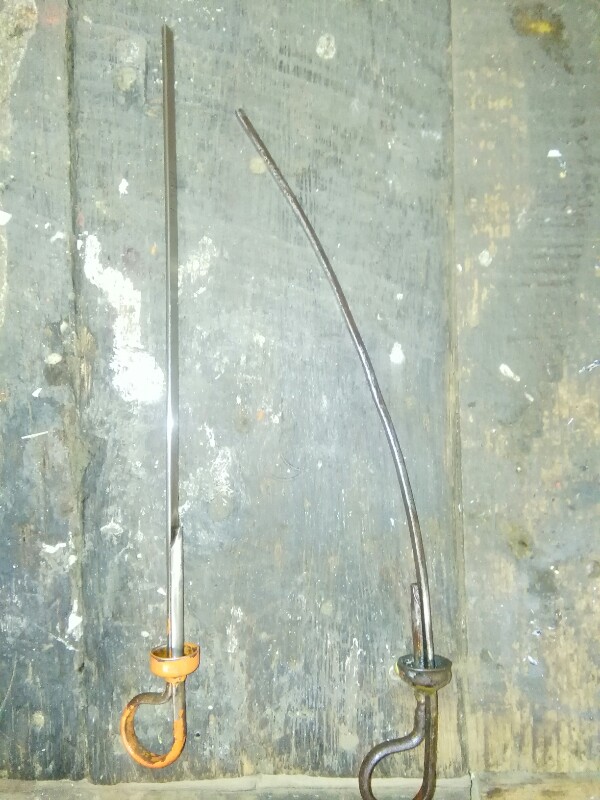

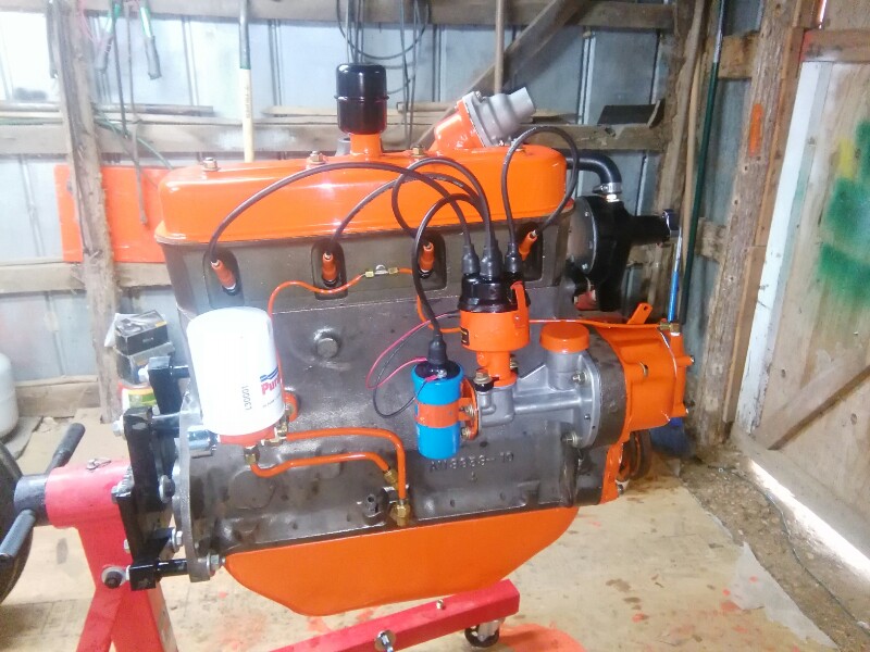

Originally posted by 79fordblake 79fordblake wrote:
Your engine looks nice.
On the dip stick look at the diff of the left one and the right one, one thing wrong with the oil level reading off is the stop cap on the right one is moving up and down the shaft needs to be tack welded after you straighten it back, left one is a WD45 or it's a replacement for WC/WD/WD45 the right one is out of a WD or later WC. Have you found the diff, the short part of the two sticks they are opposite. I'd just use the left one and toss the right one away. lol

Thanks! It sounds great to. It's only ran for maybe an hour. Now the weather is bad. The left one doesnt work either without bending it. The left one belongs to the engine that came out of the tractor. I would like to keep it with it because I may overhaul it later and stick it in something. I'll Polly buy another dipstick. Yeah Don I knew that one piece was messed up. Not sure why somebody did that to it. I gotta see if I can get some heat going in the shed and tinker around this weekend. I still have to tape up everything and paint the block. But I gotta put up some more tarps in the shed to try to hold in heat.
