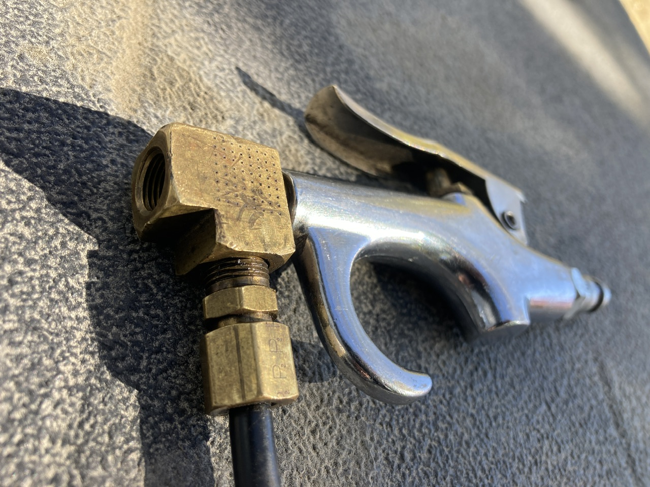

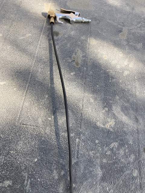

Post Options Post Options   Thanks (0) Thanks(0)   Quote RedHeeler79 Quote  Post ReplyReply Direct Link To This Post Posted: 21 Oct 2023 at 2:20pm
You can also make a handy siphon gun like this to suck out the bad fuel, or evacuate fluid from a cylinder through an injector hole or spark plug hole. It does get a little messy though!
