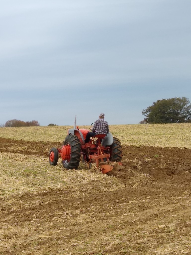

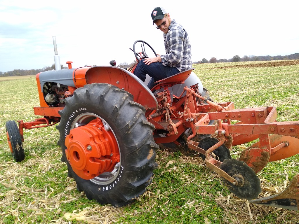

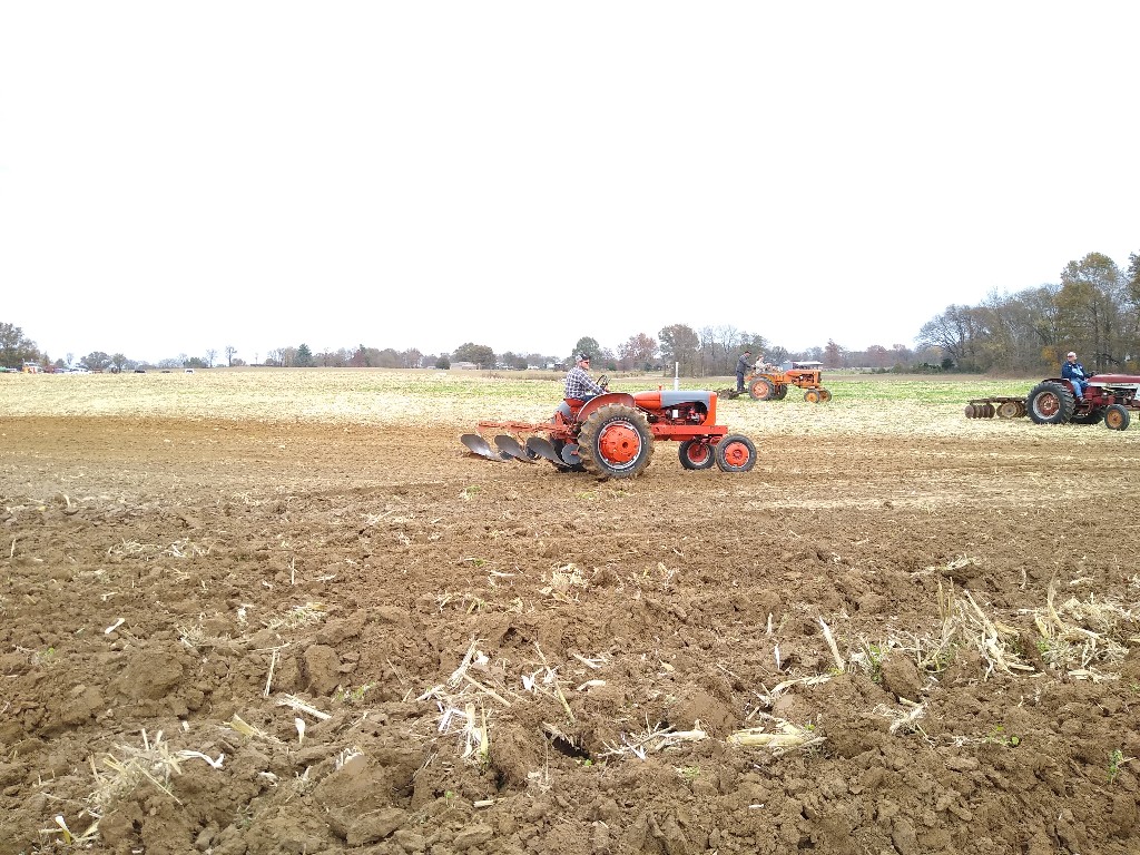

My wife took a few pictures and some videos. I had a great time. It's good to have the tractor running the way it should be. One of these days I'll get it finished(maybe)!! :)

Looks good, lots of fun to plow with!

Blake,
 Thanks for the nice plowing pictures! You have been doing some sheet metal work to the 45. It is weighted up nice too!
