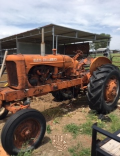

Here is a picture of the tractor and of the old part and new part.  I will see if I can find someone to weld the post in.  Thanks for the help.

Yes That new one looks good!
Good looking tractor!
