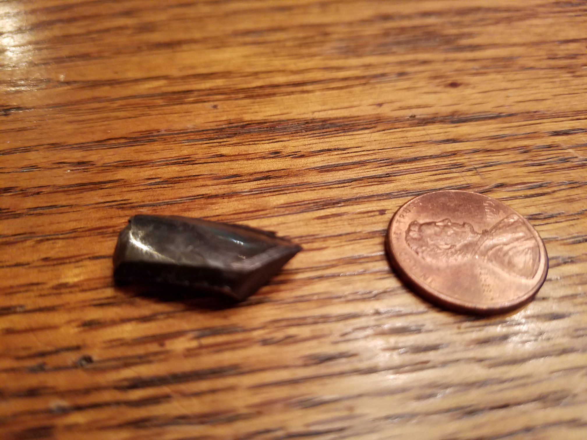

Post Options Post Options   Thanks (0) Thanks(0)   Quote MN-Realtor-Farmer Quote  Post ReplyReply Direct Link To This Post Posted: 07 Sep 2017 at 3:38pm
So I went out and took the cover plate off of the differential housing today.  I slopped out all of the cruddy oil and grease and found a piece of metal that looks like part of one of the bevel ring gear teeth.  I inspected the whole ring gear, but none of the teeth were missing.  It is possible that metal was from a previous repair as well.  I tried to inspect each of the side gears and pinions for missing teeth but parts of these are blocked while everything is turning so I couldn't see everything.  From what I did see there, everything was fine.
I jacked the tractor up and spun each final drive on their own.  The left one did not make any noise, but the right one did.  Is it possible that the issue is somewhere in the right break housing?  I'm not ruling out a pinion or side gear tooth, but prefer to check all other possibilites before splitting the rear end and removing each final drive to get to the differential for a complete inspection.

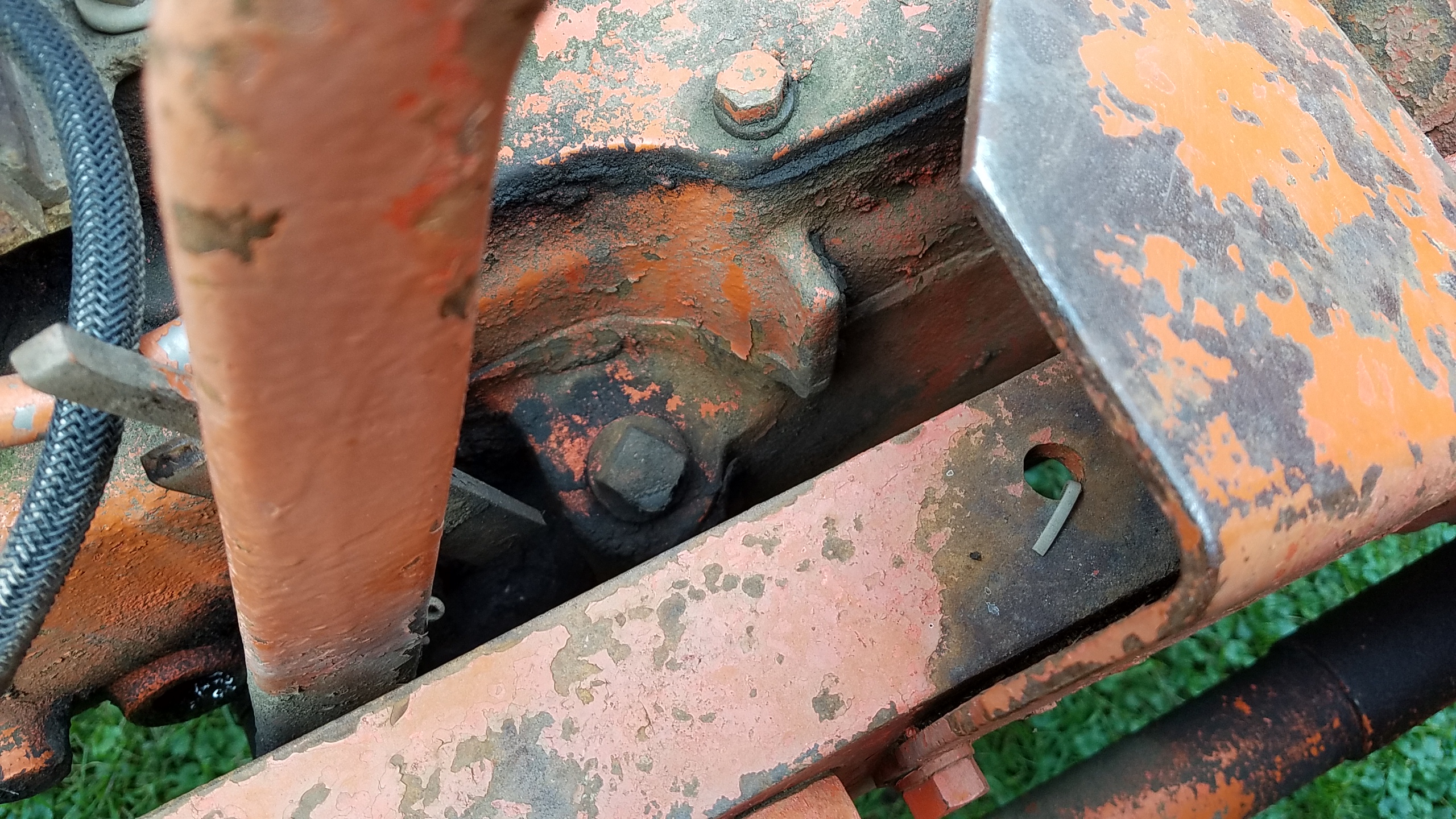

Stan IL&TN View Drop Down
Location: Elvis Land
Points: 6730
Post Options Post Options   Thanks (0) Thanks(0)   Quote Stan IL&TN Quote  Post ReplyReply Direct Link To This Post Posted: 07 Sep 2017 at 3:59pm
There is a hole/passage that allows the oil from the transmission to also fill the rear end.  Fill is from the pipe plugs along the left side rail.

pumpkinman View Drop Down
Joined: 20 Jul 2011
Location: S.E. Michigan
Points: 252
Post Options Post Options   Thanks (0) Thanks(0)   Quote pumpkinman Quote  Post ReplyReply Direct Link To This Post Posted: 07 Sep 2017 at 4:06pm
FILL PLUGS ARE ON THE LEFT SIDE OF THE HOUSING INSIDE THE FRAME RAIL BY THE CLUTCH PEDAL

Post Options Post Options   Thanks (0) Thanks(0)   Quote MN-Realtor-Farmer Quote  Post ReplyReply Direct Link To This Post Posted: 07 Sep 2017 at 4:10pm
Is that the guy I am looking for? Fill to overflow?

Post Options Post Options   Thanks (0) Thanks(0)   Quote Tbone95 Quote  Post ReplyReply Direct Link To This Post Posted: 08 Sep 2017 at 6:43am
Well......finding chunks of metal in it is never a positive sign.  Most likely digging a little deeper in that area will reveal the issue.

Post Options Post Options   Thanks (0) Thanks(0)   Quote tractorhead9542 Quote  Post ReplyReply Direct Link To This Post Posted: 08 Sep 2017 at 7:11am
From the picture that you posted that really looks like a piece of gear tooth. Can you get a better look at pinion?

Post Options Post Options   Thanks (0) Thanks(0)   Quote Dave H Quote  Post ReplyReply Direct Link To This Post Posted: 08 Sep 2017 at 7:30am
That could very well be a chunk of differential pinion  gear.
On mine the chunks under the diffy came from the pinion.
Is there some way you can take a gander at the pinion gear?
