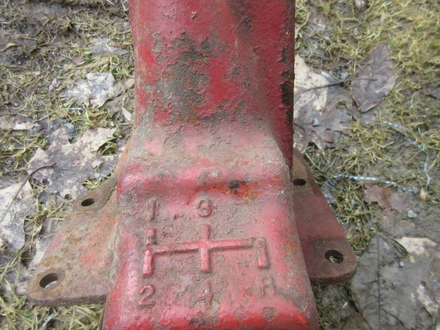

Has anyone ever run across a transmission top like this?
1953 WD, 1953 WD, WD engine with WD-45 crankshaft.

My 1953 has that cover. See number 144087.

How do I see the number you posted for me. Mine has a flip seat and what looks like a factory top link on the rockshaft.

Your serial number should be on that flat "boss" just below the LH brake spring hole as seen in one of your pictures.

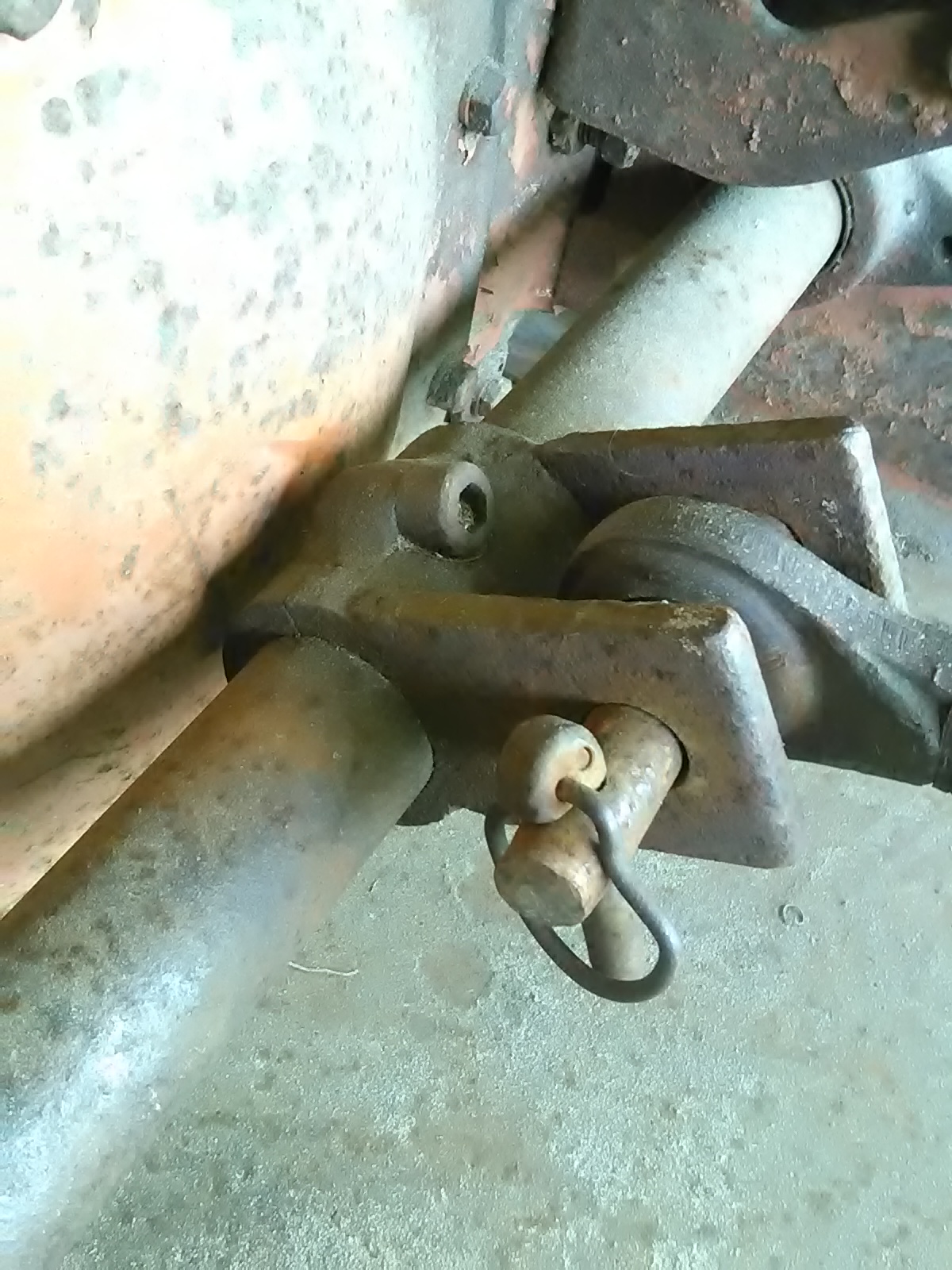

  That looks like a professionally built top-link bracket but I don't think it is a factory
A-C piece.

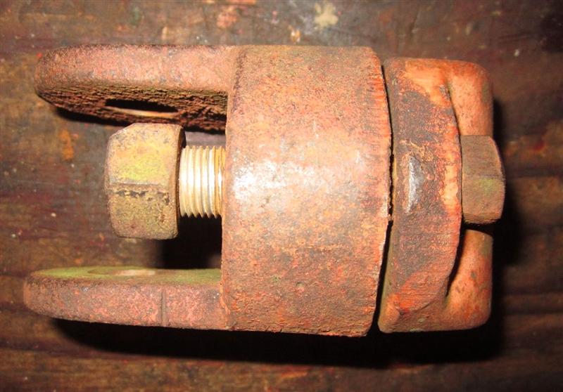

  Here are some pictures of real A-C top-link brackets.
  As can be seen, the threads on the one in the second picture have apparently been stripped making it necessary to replace the studs with bolts with nuts.

Who ever made this top link was really good.

If a WD it's a late one because it has the curved shifter for the constant mesh trans like the 45's have. Doesn't appear to be a spring hooked in that hole at rear of brakes.Need them springs to keep things in place and prevent wear of shoes.
JK,
So, your transmission has those 3 "nubs" sticking up as well?
I have never seen that but it is obvious they have something
to do with the detent springs.
Almost like someone went to extreme measures after having difficulty
installing the detent balls and springs from the underside?
It's sure a mystery to me!

Yes Brian, just like the one pictured. I always thought it was left over stock from the earlier design and they modified it to save $. The later design has less throw so the detents would have to be moved? I have never compared them but it may have been more complicated than just moving the detent in the rails.
Points: 22062
Post Options Post Options   Thanks (0) Thanks(0)   Quote DrAllis Quote  Post ReplyReply Direct Link To This Post Posted: 18 Mar 2019 at 9:36am
I have seen that design a couple of times over the years. I never really paid any attention as to what year the tractor was built that had that 3-nub cover. I have a very late WD45 and it doesn't have it. I'd suggest that at some point (or more than one) in time they had some shift covers that were made wrong (too deep of spring hole for detent ball) and this was a "salvage" process to avoid having to scrap those shift covers??  Just a thought as to why...……..
OK, so the good Doctor confirms what you guys are saying....there are some out there.
I like your theory....it makes sense.
I have 3 late model WD-45s and 3 early model (straight shifter)  WDs and none
have those nubs.
The funny part is that his tractor is a fairly late model WD-45 and  its not likely there would have been any "left over" covers at that point.
Oh well......maybe somebody changed the cover at some point and happened upon one of
those oddball units?
We will probably never know.
It sure was an interesting discussion though!

I think JK solved the mystery!

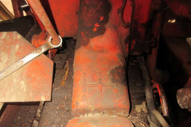

The casting for the curved shifter transmission has a "hump" right where those nubs are.
The straight shifter transmission has no hump there.
If you look at savedallis' transmission, you will see clearly there is no hump but those nubs stick up in it's place.
So.....I would surmise that, like JK says, they used the old castings 'til they were gone but had to make that modification in order to make room for the detent springs.

The first picture shows the straight shifter cover, the second picture shows the curved shifter cover.

I think all the early helical gear transmissions used that cover, late 1952 thru 1953 WD and maybe early WD45. My '53 WD has it but I've never seen a WD45 with one.

My Dad's 1953 WD did not have those nubs. It was exactly the same as the other three WD-45's that were on our and my Uncle's farms.
