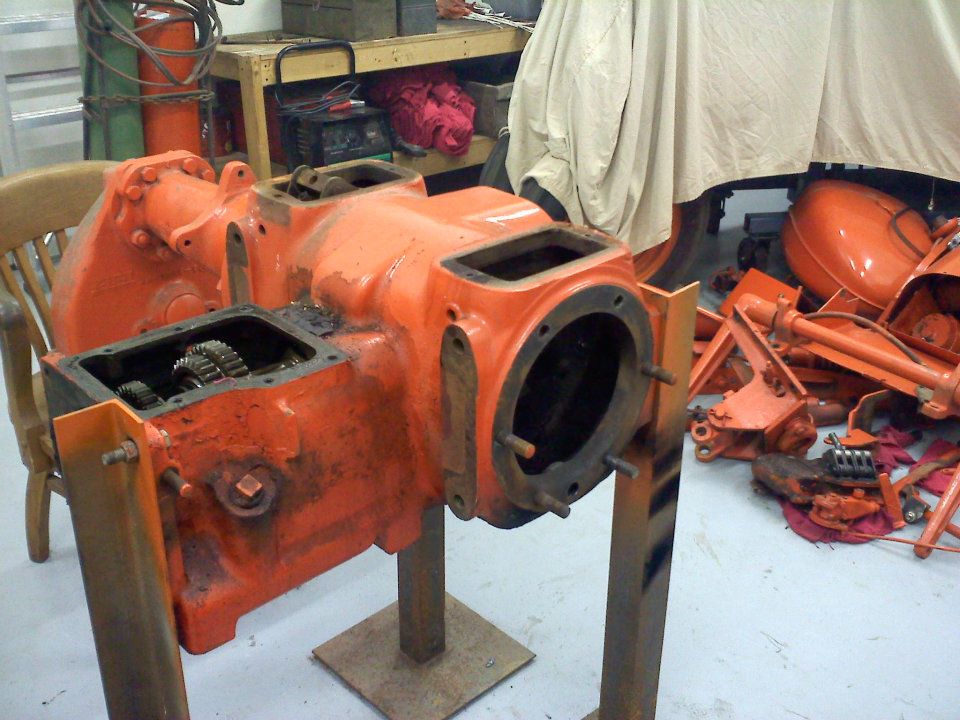

Post Options Post Options   Thanks (0) Thanks(0)   Quote Mike56073 Quote  Post ReplyReply Direct Link To This Post Posted: 08 Mar 2012 at 2:02pm
   Get it at least as far apart as the above picture, then take the trans gears out throught the top.  Yes, it is ALOT of work, but anybody can do it with some time, patience, and basic hand tools.
