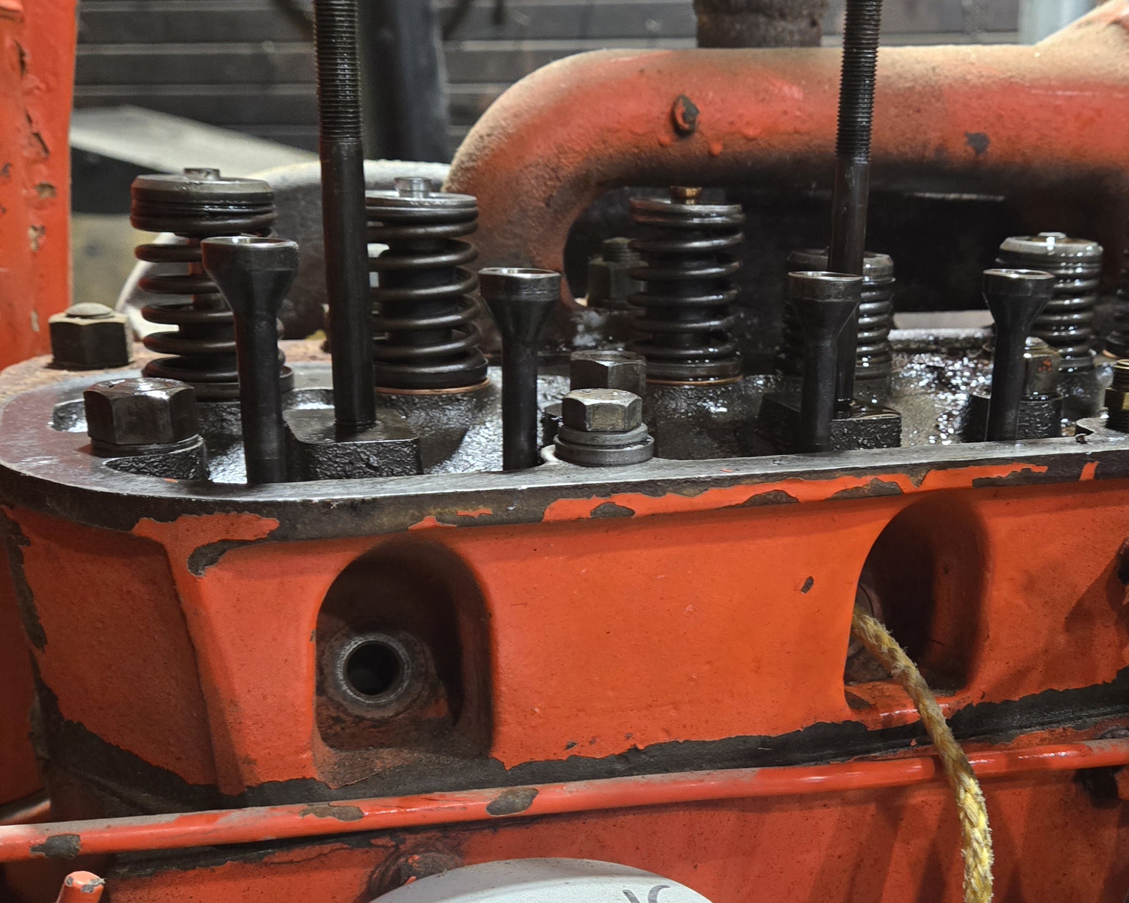

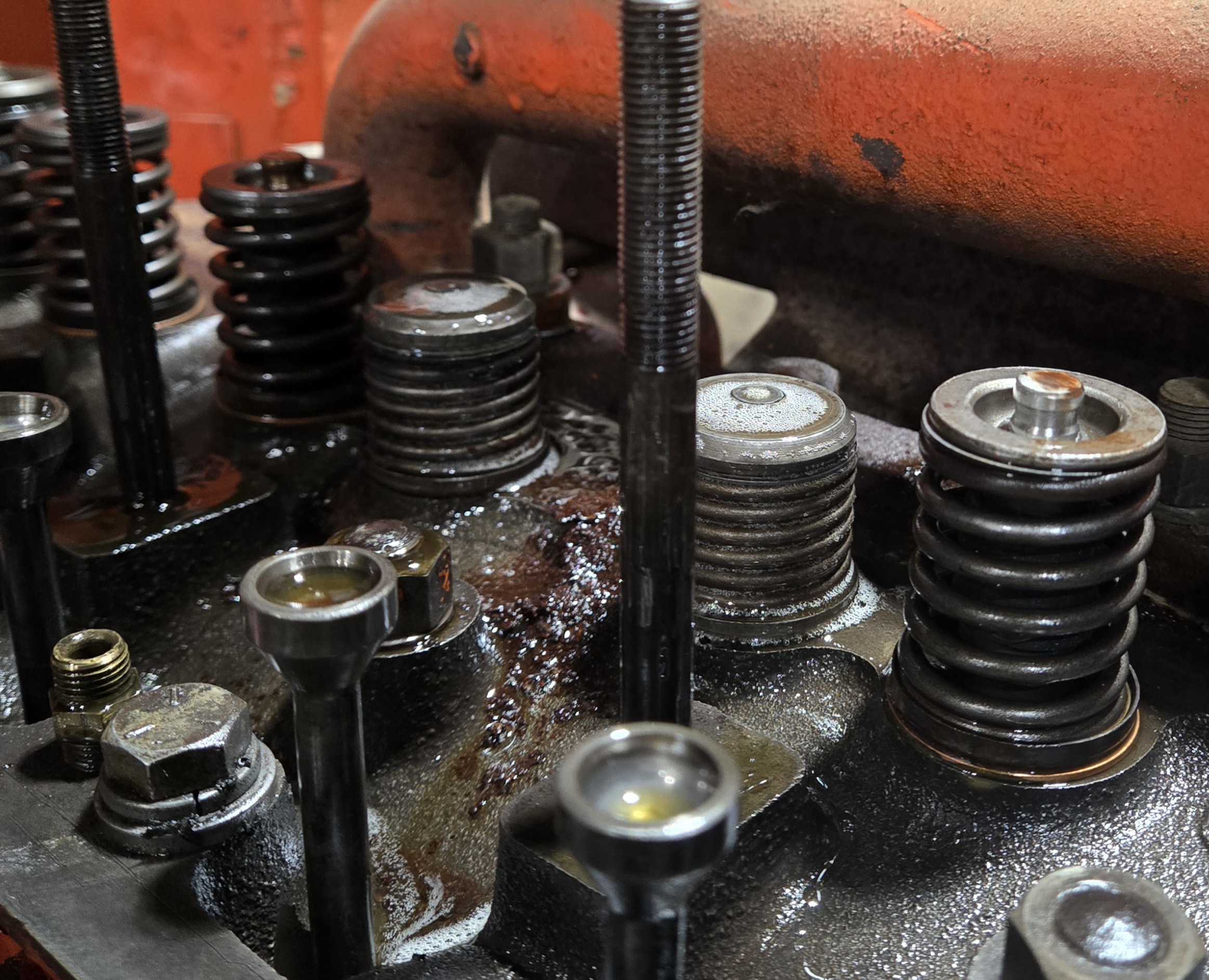

Originally posted by ToddnwIl ToddnwIl wrote:
Alittle update. The rope trick worked perfectly! We soaked them down really well. 20250210_180357.jpg20250210_180909.jpg
Nice! Smile
I used the rope trick last summer on my Model C to hold the valve up when I replaced a broken valve spring.

Post Options Post Options   Thanks (0) Thanks(0)   Quote ToddnwIl Quote  Post ReplyReply Direct Link To This Post Posted: 10 Feb 2025 at 7:56pm

Lots of penetrating oil from the top side. Get about 10 ft of nylon rope small enough in diameter to shove down inside the spark plug hole (5/16" ?) while the piston is at BDC. Have a knot tied in the rope so you don't lose it. Turn engine over by hand with all that rope coiled up inside. Rinse and repeat for the second cylinder.
