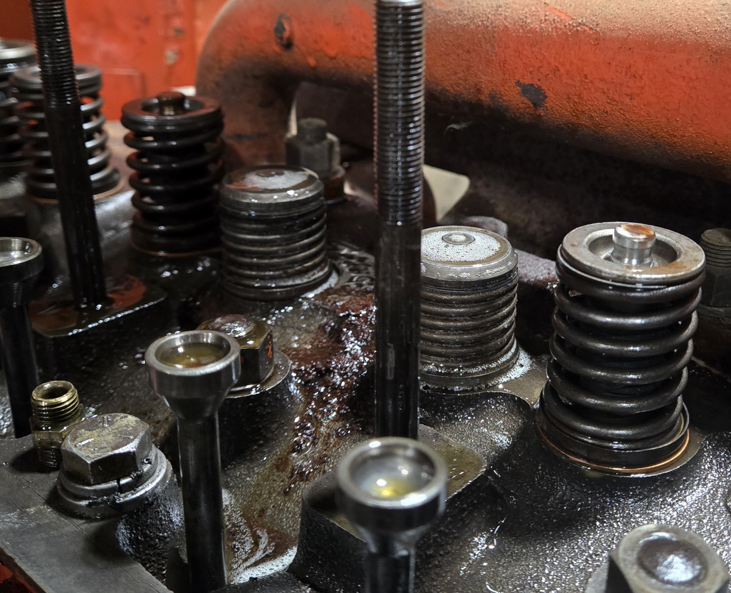

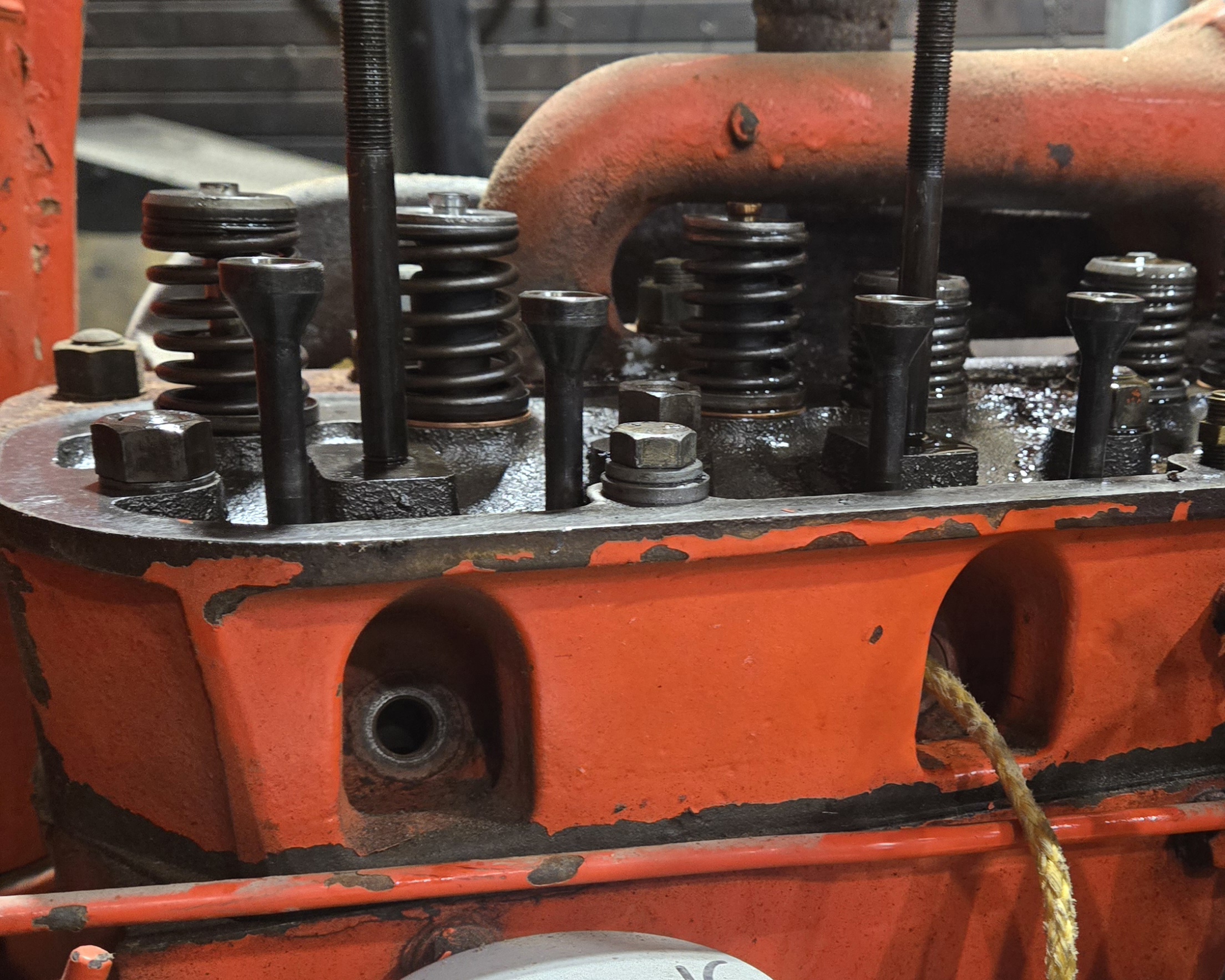

Post Options Post Options   Thanks (0) Thanks(0)   Quote ToddnwIl Quote  Post ReplyReply Direct Link To This Post Posted: 10 Feb 2025 at 7:56pm
Alittle update. The rope trick worked perfectly! We soaked them down really well. 20250210_180357.jpg20250210_180909.jpg
