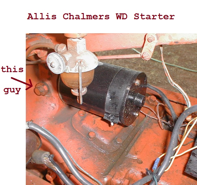

Originally posted by Slowmotion Slowmotion wrote:
I see what look like two large, slot head screws on opposite sides of the starter.
Grabbed a pic from the googles and put a bit of arrowing on it. Hope this helps. If yours looks somehow different, please provide a pic!
WD Starter

I found it. It's very clear with that photo. That makes sense, and what I was looking at didn't. I tried to break the bolt loose with a box end wrench this evening, but couldn't. I'll try again tomorrow with a bigger wrench. It looks like it's been many moons since the starter has been off the tractor.

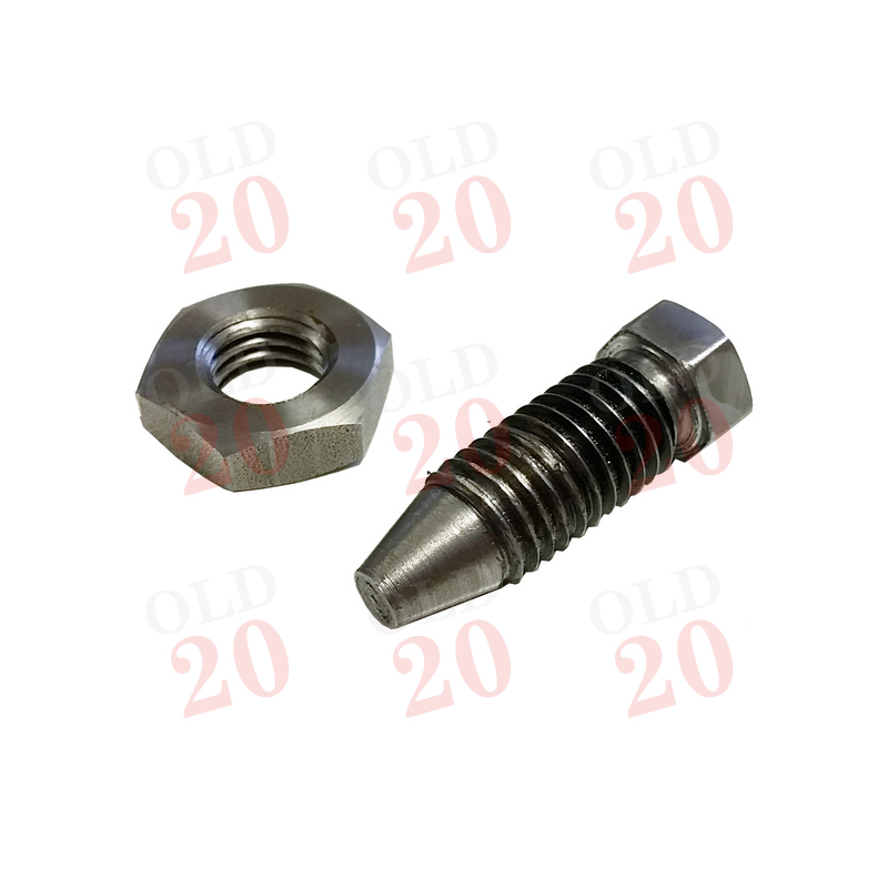

Here are a couple photos of the starter mounting setscrew and nut. It is possible that the nut will be rusted to the setscrew when you remove it and they can and will come out together at times. You can free them up after they are out. Clean the threads and coat with anti-seize before installing.

On 2 of my D-14s, the bolt and nut came out as one unit. I put the bolt head in a vice ,then added some propane torch heat, some oil and  carefully removed the nut.
FIRST thing though... disconnect and remove battery from tractor !! Yeah, kinda obvious but I know someone who put a big wrech down on the MISSING battery box cover one day..
 When you get the nut and bolt off, file any ridges on the tapers of the bolt. Also remove any paint,rust where the jam nut and the starter meet the cast iron.

If you have never seen one of these tapered, sq head, screw with the large jam nut, well welcome to the WD world of Allis. This was a favorite locking method for them.
 A little off topic but this is a partial list the places on a WD series that they exist:
- Starter
- crank pulley
- belt pulley
- I think there is a small one in the PTO box
- small one in the hand clutch compartment
Others?
