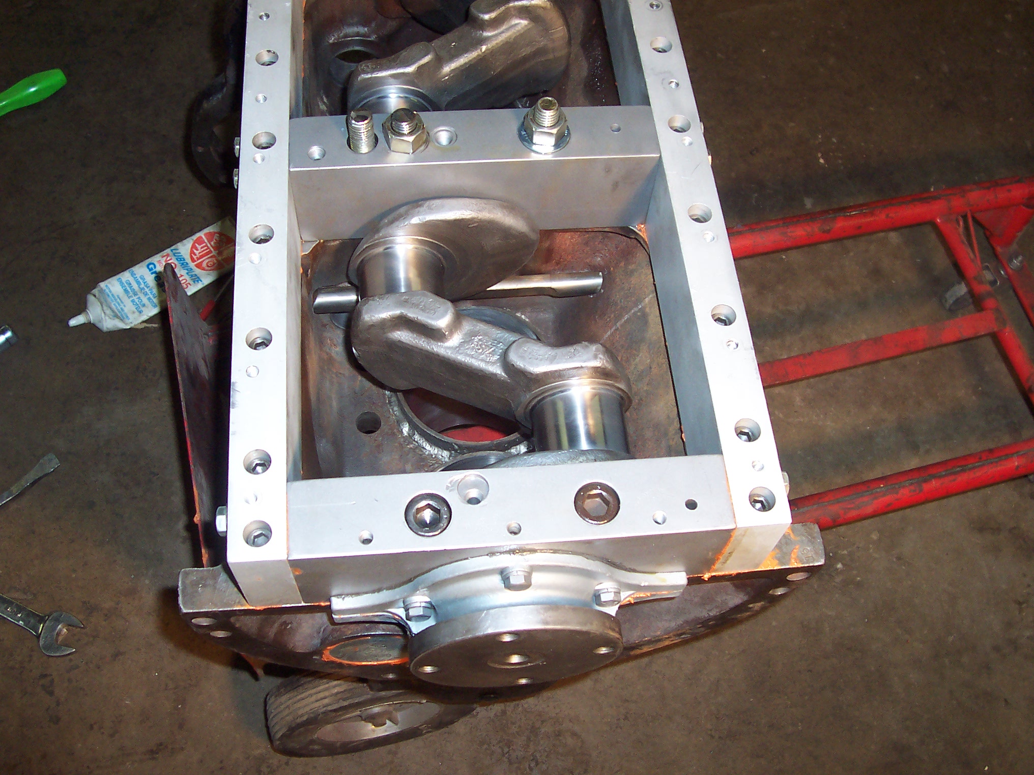

Years ago when I was running the WC in our local pulling association we didn't have much for rules, but had to have a "stock block"  Not much else mattered.  Fellow built a MM Z with a billet alumnium head, overhead cam setup.
I had to run the 201 block, it was almost a problem to use a later #40 block, but it was alright.  I could not use a 45 block.  I would have loved to be able to use D-17 and Gleaner E parts, common and much much stronger but the Oliver guys seamed to have a problem with the Allis guys and made sure we had the right parts.
So being nothing was impossible, but some things take a long time, I hogged out billet caps, girdle, cross bolted the block above the center main and tied the deck to the crankcase by welding the sleeves in.  I cross bolted the new main caps to the pan rails. We didn't have any oil pan restrictions or such like I think some NATPA classes to with a certain thickness girdle.  It was pretty strong and proved to be bullet proof for many many years even taking a hit of NOS when the rules would allow.  At first getting much past 5200 RPM proved more than stock rocker arm shaft could handle, the ends of the shaft that were un supported would just bend up.  Then I made L shaped brackets to go under a head bolt on each end and slugged the ends of the rocker shaft and bolted them down.  That took care of things, much over 6500 RPM though the valves would float.  I had changed valves and springs, different cam profile and ran a downdraft carb with a new intake setup and with a light load in the yard in testing the pipes were ringing pretty good and the recall on the tach said 7050 rpm so I never tried to turn it that hard again, I figured the setup was fine.  I got into the Alcohol Super Stock and just haven't messed with it since.
If I had to build over again, I'd counterweight the crankshaft to take the stress off the block.
I just built this
Edited by wi50 - 24 Feb 2014 at 9:31am
