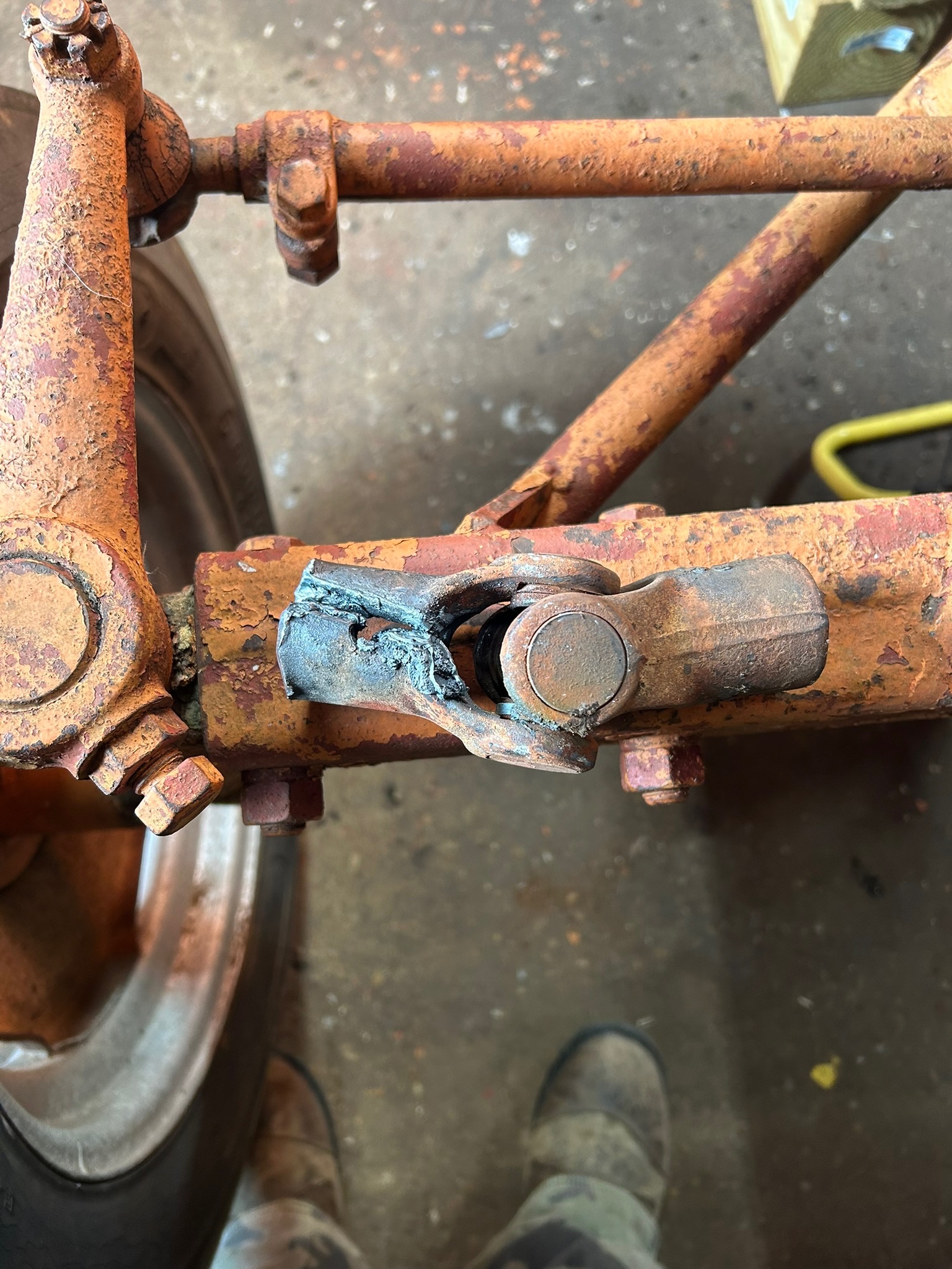

Post Options Post Options   Thanks (0) Thanks(0)   Quote AC720Man Quote  Post ReplyReply Direct Link To This Post Posted: 13 Dec 2025 at 11:19pm
Spent 2 partial days removing the NF and installing the WF. The steering universal joint was a bear to remove, well mainly driving the pins out. Had no luck driving it out so I decided to drill it out. Got a 1/8” carbide drill bit thru, went to the next bit but snapped off right before exiting the other side. It felt like it grabbed hard and snapped. So, my buddy Mutt pulled out his torch and he proceeded to get it red hot as I started to drive the pin. Finally after a half hour of pounding the pin came out. Drove it off the shaft and then removed the NF. The next day the process of getting it off the steering shaft started the same way but I couldn’t budge the pin until once again heating it cherry red. Finally drove the pin out. Tried to drive the universal off the steering shaft, even with it red hot it wouldn’t budge. The universal needed to be replaced because it was worn out so I asked Mutt to cut the universal parallel to the shaft with the torch. He did so without damaging the shaft. After some pounding it finally came off. Installing the new used universal joint was simple after cleaning up the shafts. The rest of the WF install was pretty easy. It’s all back together for the new owner.

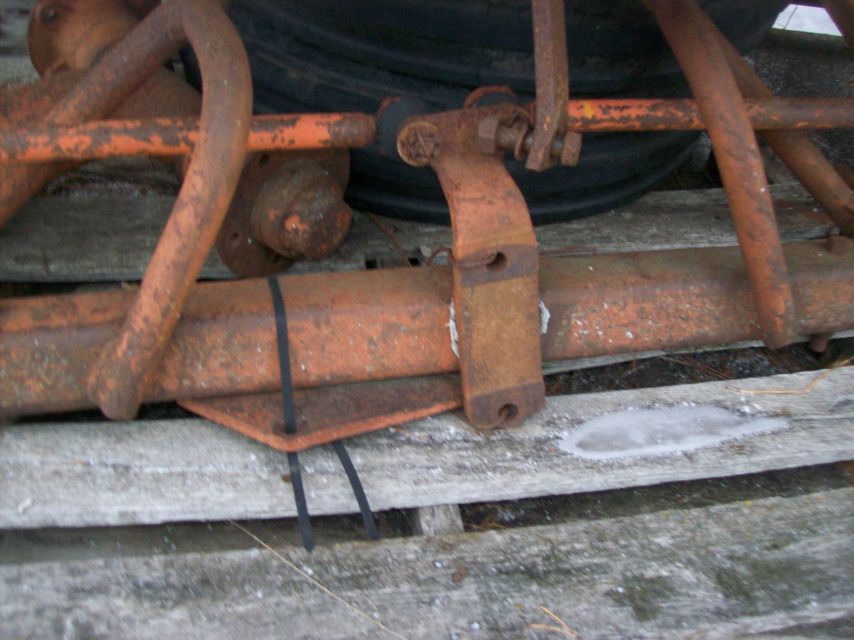

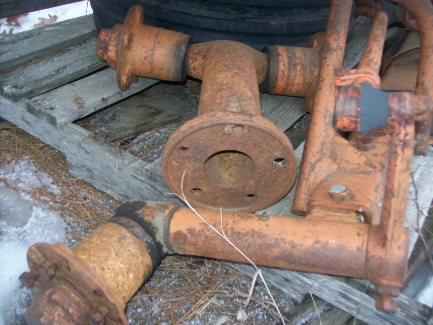

Post Options Post Options   Thanks (0) Thanks(0)   Quote MNLonnie Quote  Post ReplyReply Direct Link To This Post Posted: 18 Dec 2025 at 3:21pm
Here are the wide and narrow fronts. The single front is on the tractor along with a set of Arps tracks. Just remove 5 bolts and swap it out, supper easy and fast. No messing with steering at all.
Points: 5457
Post Options Post Options   Thanks (0) Thanks(0)   Quote AC720Man Quote  Post ReplyReply Direct Link To This Post Posted: 18 Dec 2025 at 8:56pm
Thanks for the pics, wasn’t aware that could be done. Easy to see how it works.
