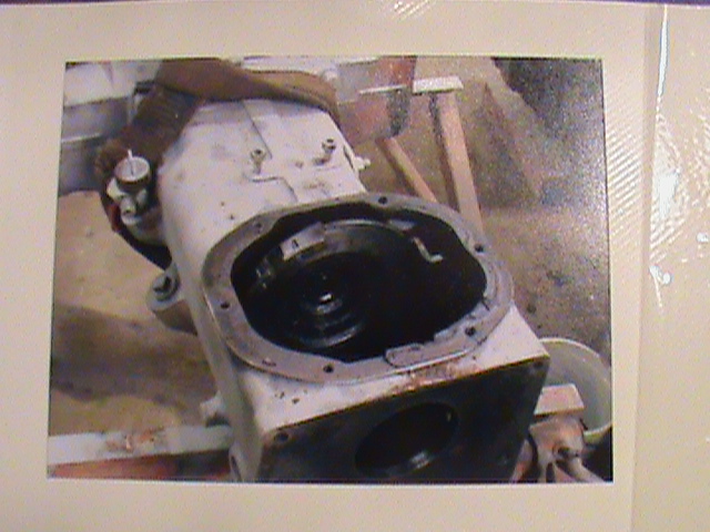

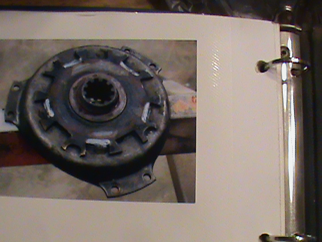

Phil Brown made mine. I found a couple of pics for it. He used parts of the hand clutch and center from a truck 10 spline disk. Phil should make and market these. Very strong and light.

Post Options Post Options   Thanks (0) Thanks(0)   Quote Fields Quote  Post ReplyReply Direct Link To This Post Posted: 11 Feb 2013 at 8:32pm

its 10 spline 1 1/4 u canbuy a coupler at a hyd supplier or i got one out of wc trans output shaft
