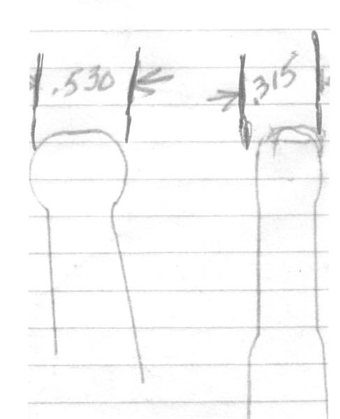

Someone posted this on here years ago.
Might prove to be helpful if you want to "tune up" the shifter end.
The other thing to check are the pins at the top of the tower that keep
the shifter from turning.
There are two with the curved shifter and one with the straight shifter as I recall.
The pins on the curved shifter wear more quickly because of the constant torsion
put on them from the curve in the shifter.
I "tuned" the ends on both my WD and WD-45.
I also made oversize pins for the WD-45 from either 1/4" or 5/16" Gr 5 bolts.
Can't remember which.
I think aftermarket shifters and oversize pins are now available....check
some of the vendors here.

I should add this is a late WD with the curved shifter. I'll take the shifter out and measure it. I'm figuring dimensions posted below are accurate?
Nathan (SD) View Drop Down
Location: Day County SD
Points: 1304
Post Options Post Options   Thanks (0) Thanks(0)   Quote Nathan (SD) Quote  Post ReplyReply Direct Link To This Post Posted: 09 Jun 2019 at 12:58pm
Those are minimum numbers in my opinion. I go a few thousandths bigger on both dimensions. Most times the shift notches have wear also. Have seen a new shift lever still slip out of worn notches. Not hard work, just time consuming.
