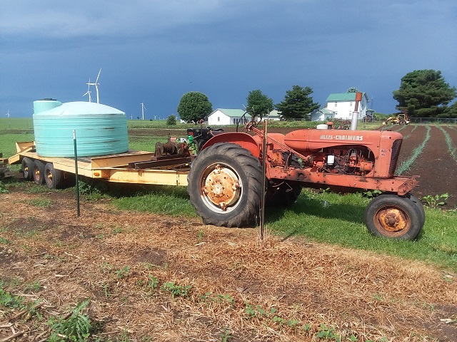

All of my wd and 45's do the same thing.--tank cleaning and auto filter don't help either.
Some say the tanks will need to be coated inside to stop the problem.
My 45 dumped me the other day on the road pulling the tri-axle loaded with the big water tank.---Had to walk home and carry a air tank with blow gun and blow rust out of the load jet, then we came on home purrin like a kitten! LOL!! thanks; ac fleet
