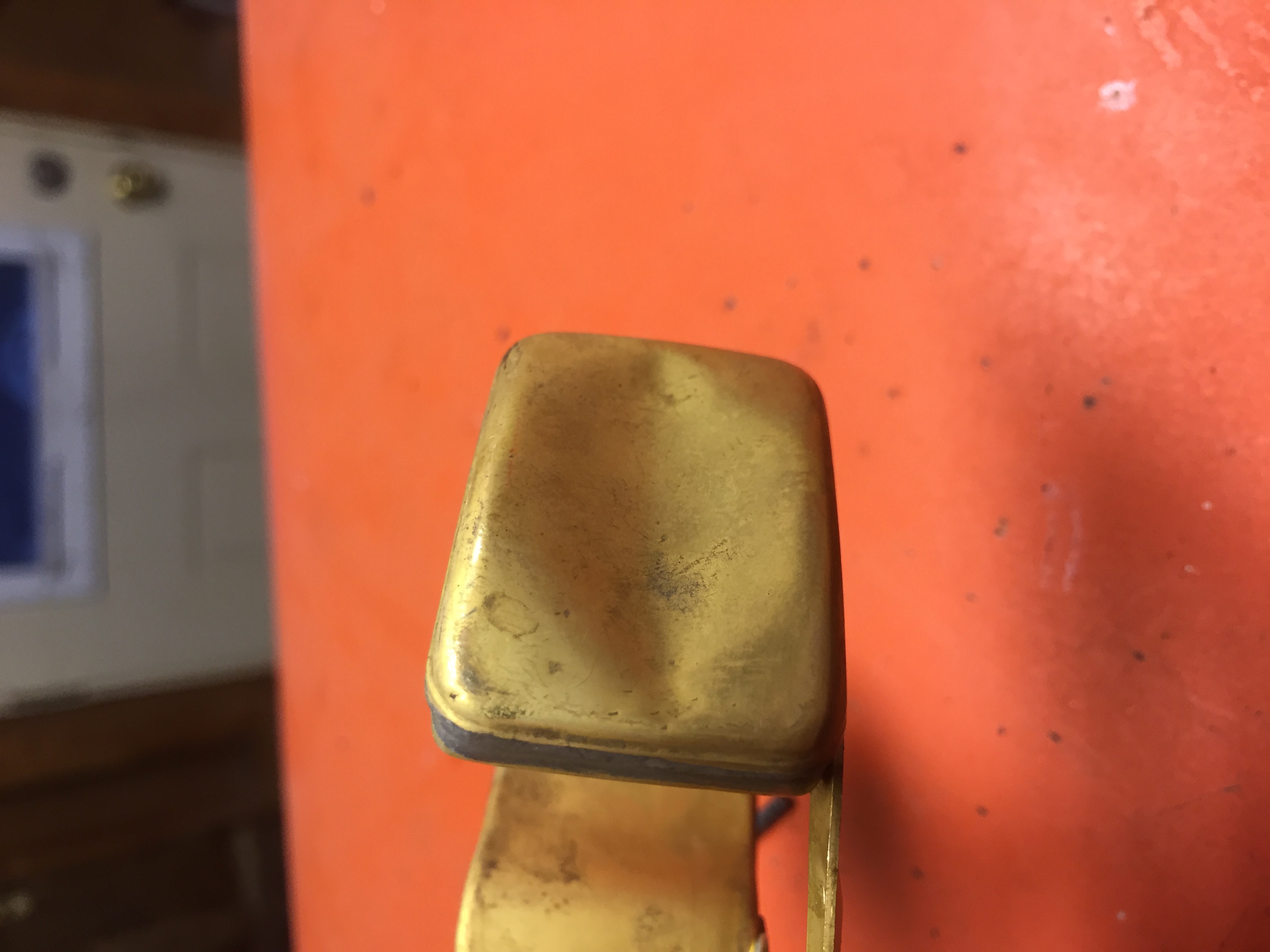

Post Options Post Options   Thanks (0) Thanks(0)   Quote CTuckerNWIL Quote  Post ReplyReply Direct Link To This Post Posted: 14 Jul 2016 at 6:40pm
This piece needs to be removed and cleaned.

Post Options Post Options   Thanks (0) Thanks(0)   Quote cpg Quote  Post ReplyReply Direct Link To This Post Posted: 14 Jul 2016 at 8:04pm
Thanks for the tips, I will make sure I check to bore and put in a bushing. I had all the parts out that would come out like the piece pictured above and cleaned it out but like you say there is probably crud down in the carb passages. My plan is to pull it apart and get a can of the chem-dip for soaking carbs and strip it totally down to the cast iron and let it soak for a while then do the total rebuild kit with new seat, float, and throttle shaft.
