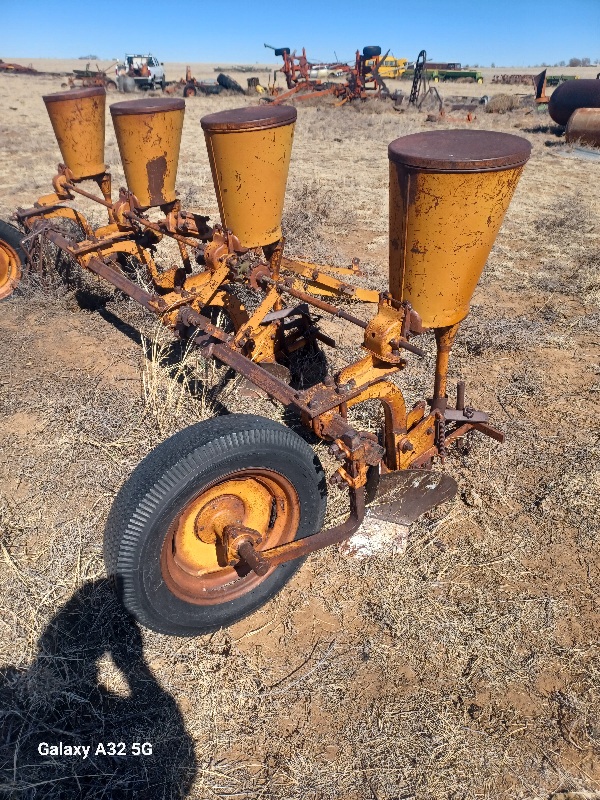

Sorry, you did say the 4-row wasn't your grandfather's and I forgot already. Broom corn is interesting. Never would have guessed that.

Neat! You occasionally see bedding/listing equipment around here, but it's not as common. That 4 row you have still has a lot of original paint on it and will look great at a show. What crops did your grandfather plant with it?

This is a 4 row that I've had for a long time,it's jus to wide to haul around. I'm gonna put this snap coupler hitch on it and display with a WD-45.

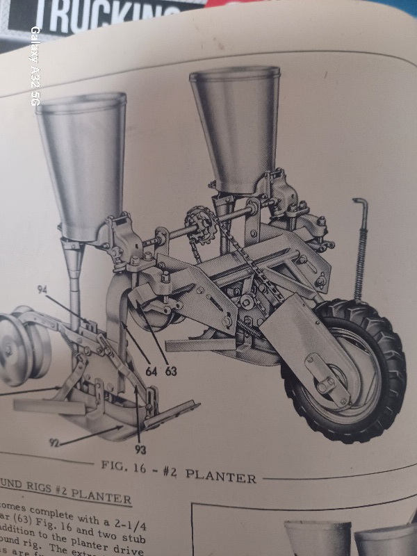

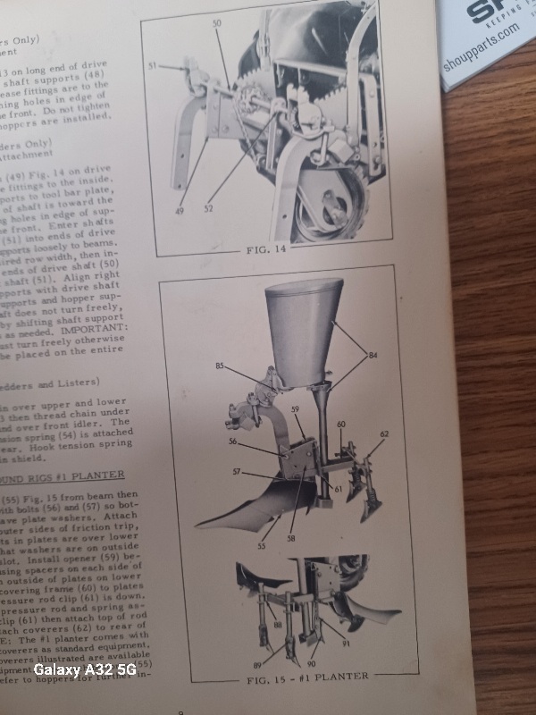

[IMG][/IMG]
John,, the planter I have has this style drive. The book I have doesn't even show the tractor wheel drive, not even in the parts breakdown in the back of the book....???
I've got the #1 planter with the lister bottoms as shown...
And, this book is for 2 row planters,,,3 row bedders,, I'm takin a wild a$$ guess that the tractor wheel drive is for planters bigger than the 2 row
