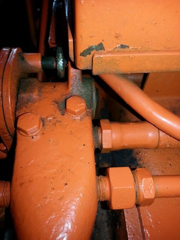

Post Options Post Options   Thanks (0) Thanks(0)   Quote irlbeck A-C'S Quote  Post ReplyReply Direct Link To This Post Posted: 07 Sep 2017 at 9:14am
The first pic is the top of the valve.
The line that is disconnected was the steel line for the remote.
The other pic is from the side. It shows 2 on one side and you can barely see the other fitting on the opposite side.
