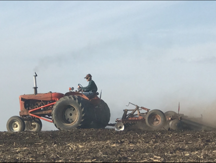

I have a 45d with a d19 turbo diesel engine, it works nicely in the field other than the head gasket has problems sometimes...
