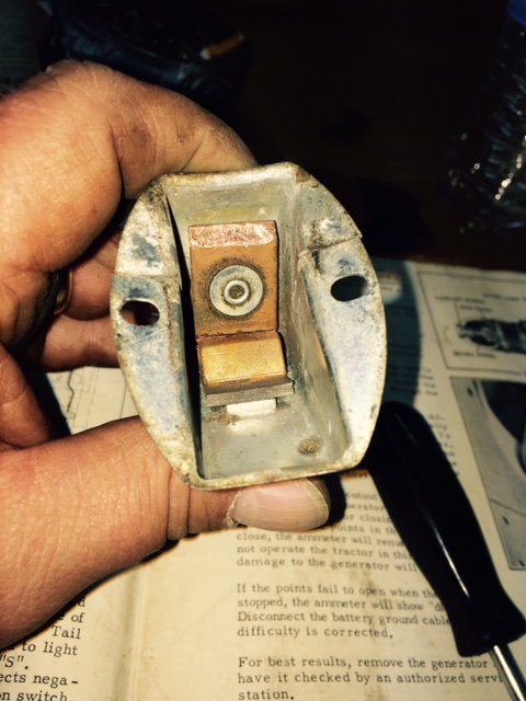

Just a suggestion...
Take the starter switch off again and polish the inside contact points.  My CA wouldn't start once and I was sure the battery was good.  A little polishing/scraping and my electrical contacts were good again.  HTH.

Okay, Trace-  if your switch looks like the one Brian F showed a picture of, take it apart again, and cycle the plunger, and compare it to the post on the starter.  that contact is suppsed to bridge 'tween the battery and starter terminal.
I dealt with this a dozen ago on my B, and then again mebbie five ago with my WD45... the arrangement is same.  The B gave me royal fits 'till I figured out that the replacement switch (brand new, but aftermarket) was simply NOT moving far enough to bridging the contacts.  I'm pretty certain the starter post was a bit worn, but I'm also dead certain that the replacement switch assembly was misshaped crap.
Now, I've slept two or three times since then, so I can't tell 'ya what I wound up doing to make the darned thing work, but I pulled the switch apart and made some modifications.  I don't recall wether I wound up putting it in the mill, or hand filing, or rotating the starter terminal, or mebbie I put a spacer under the starter terminal to get it up higher... mebbie I added metal to the lever's nose, I simply don't recall... but that's what it needed.  And yep... it's a real PITA 'till 'ya get it fixed.
