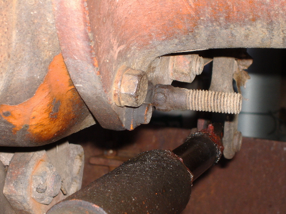

Post Options Post Options   Thanks (0) Thanks(0)   Quote stu(ON) Quote  Post ReplyReply Direct Link To This Post Posted: 05 Jun 2012 at 9:49pm
Looks like one side was still stubborn, so here's another approach.
I did like this on my D17. I slipped a deep well socket over the welded on bolt and it drew the pin right out.
