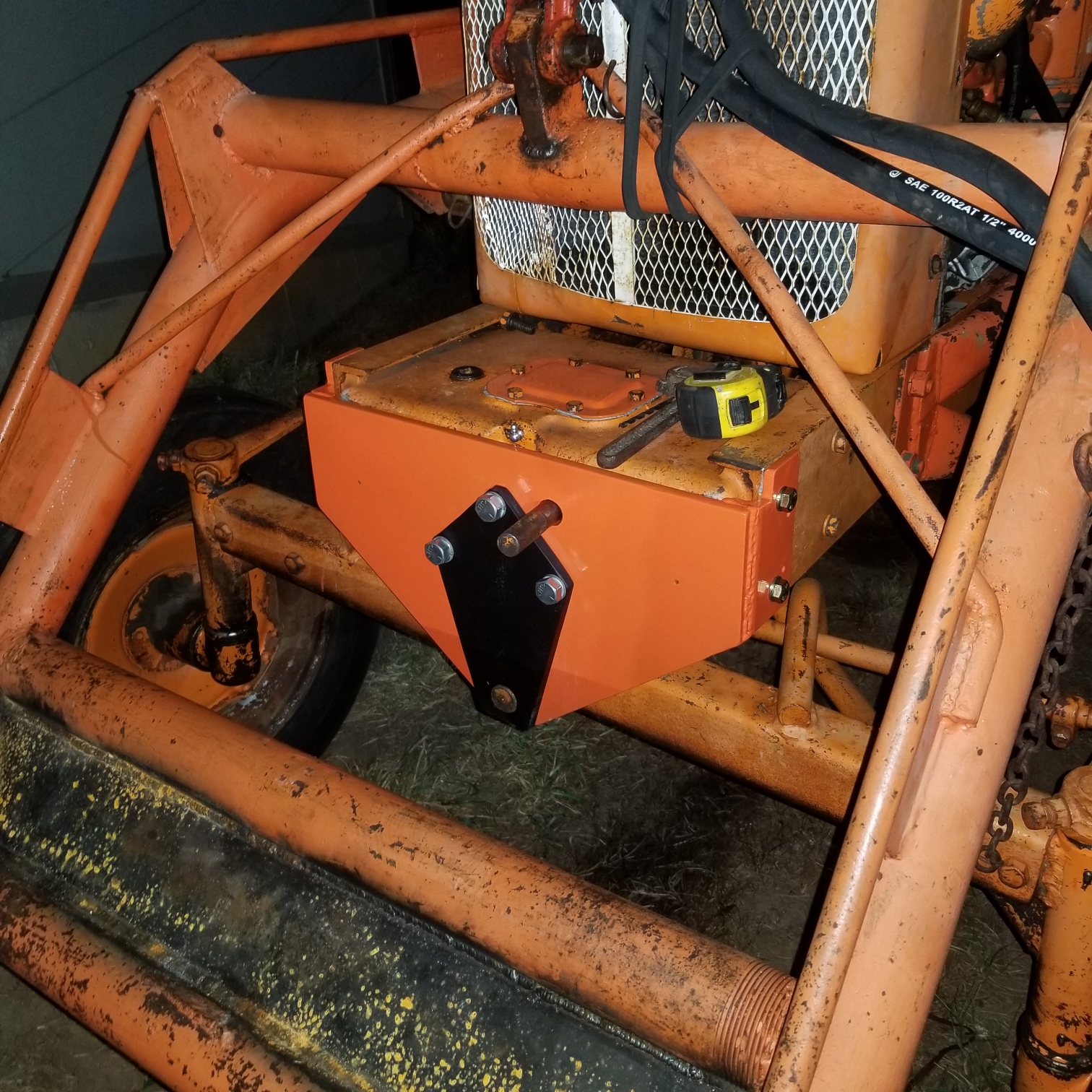

I just did this

Is this underneath the tractor front bolster? I think Drallis has your solution.
My WD was busted up like Catalinacrasher's but I just welded back in the bolt holes and redrilled and tapped them. Made the mistake of not using welding rod that was soft so it could be drilled and tapped easily but I got it done. Had to keep cutting the tap off and tapering it. Used up two taps doing it.

Yes, it is underneath the bolster, the arm to the tie rods, seems like kind of a weak point but hey 60 years + not too bad.  Previous owner beefed up the 3 bolt but not to the extent shown here-good job.  Seems like to bolt a single front wheel or tricycle for a corn picker would put an awful stress on the fork shaft.  I know my Dad did it when switching out for a picker.  I'm going to try Dr's fix when I can borrow  I think it's a 5/8 tap.
