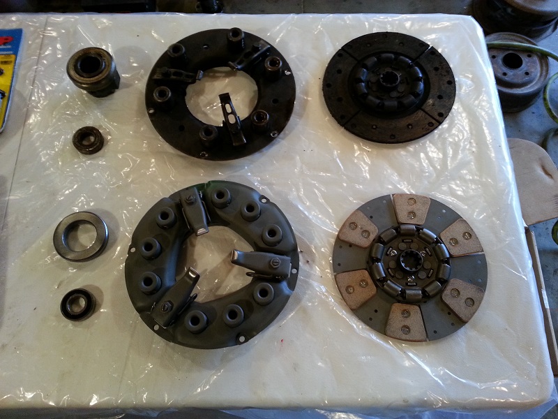

Fella's  I am currently in the process of replacing the clutch on a 1941 Wc and i was wondering if anyone out there could tell me if I could use the 9 spring heavier duty clutch that i believe was on the later model wd45's? I was thinking this would be an improvement over the stock 6 spring that I removed. The only thing else I also wondered was if this can be done, would the pilot bearing also go in instead of the pilot "bushing" that it currently has?  I know that some of you guys have experience in this and would very much appreciate any help you could offer. Thanks so much, sincerely Hoss

I have done it to my two WD tractors with modifications should bolt right up to your fly wheel

Did the same thing with my WD, the 9 spring setup came from Rick Corder, bolts up just fine. If you go through Rick he will make whatever kind of disc you want- fully lined, 4/6 button, spring, solid, etc. He also includes the correct pilot and throwout bearings. Be sure to get your flywheel face turned too.
