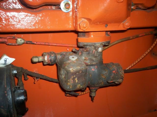

Finished mounting the starting tank.
It had a plug in the carb.
I'm not happy with this 1/4 turn valve but I couldn't find a better one locally and the Ace Hardware guy swears this is ok for fuel.
I needed an 18" line, of course I could only get a 12" or a 20", so I had to do some creative bending to deal with the excess. An 18" line would have had one 90% radius bend. I still have to take the tank off and paint it and I'm going to use thread sealer on the valve and fittings in the bottom of the tank.

Post Options Post Options   Thanks (0) Thanks(0)   Quote Dave in il Quote  Post ReplyReply Direct Link To This Post Posted: 18 Sep 2011 at 10:46pm
Yes, I got a cap you can see it in the picture.
