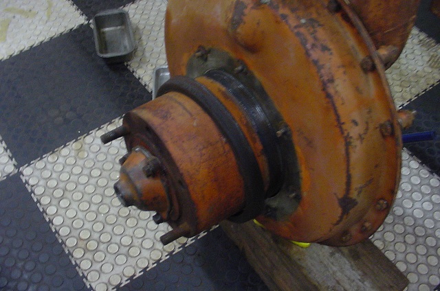

The seal goes on the outside of the hub.
See the picture.

Post Options Post Options   Thanks (0) Thanks(0)   Quote CAL(KS) Quote  Post ReplyReply Direct Link To This Post Posted: 02 Aug 2017 at 7:56am
you need the inner pinion seal then not the final drive seal.
agco # is 70202602
crosses to skf #19407
Stock Number 19407
Description LDS & SMALL BORE SEAL
Lip Code Nitrile (Lip Code: R)
Type/Style CRW1
Inches Shaft 1.938
Bore 3.189
OD 3.194
Width 0.313
Weight 0.125
parts book also shows some kinda of inner seal that is different on steel rear end models.  im guessing this was a 2 piece seal and the former has replaced it

Yes I noticed after I messaged you today that I had made a big mistake by saying hub seal.
Anyway we got there in the end, many thanks for the dimensions hopefully now I can order the seals !! how does one remove and replace the inner one ? is it through the top of the brake casting ? I am sure all will become clear once I strip her down !!
