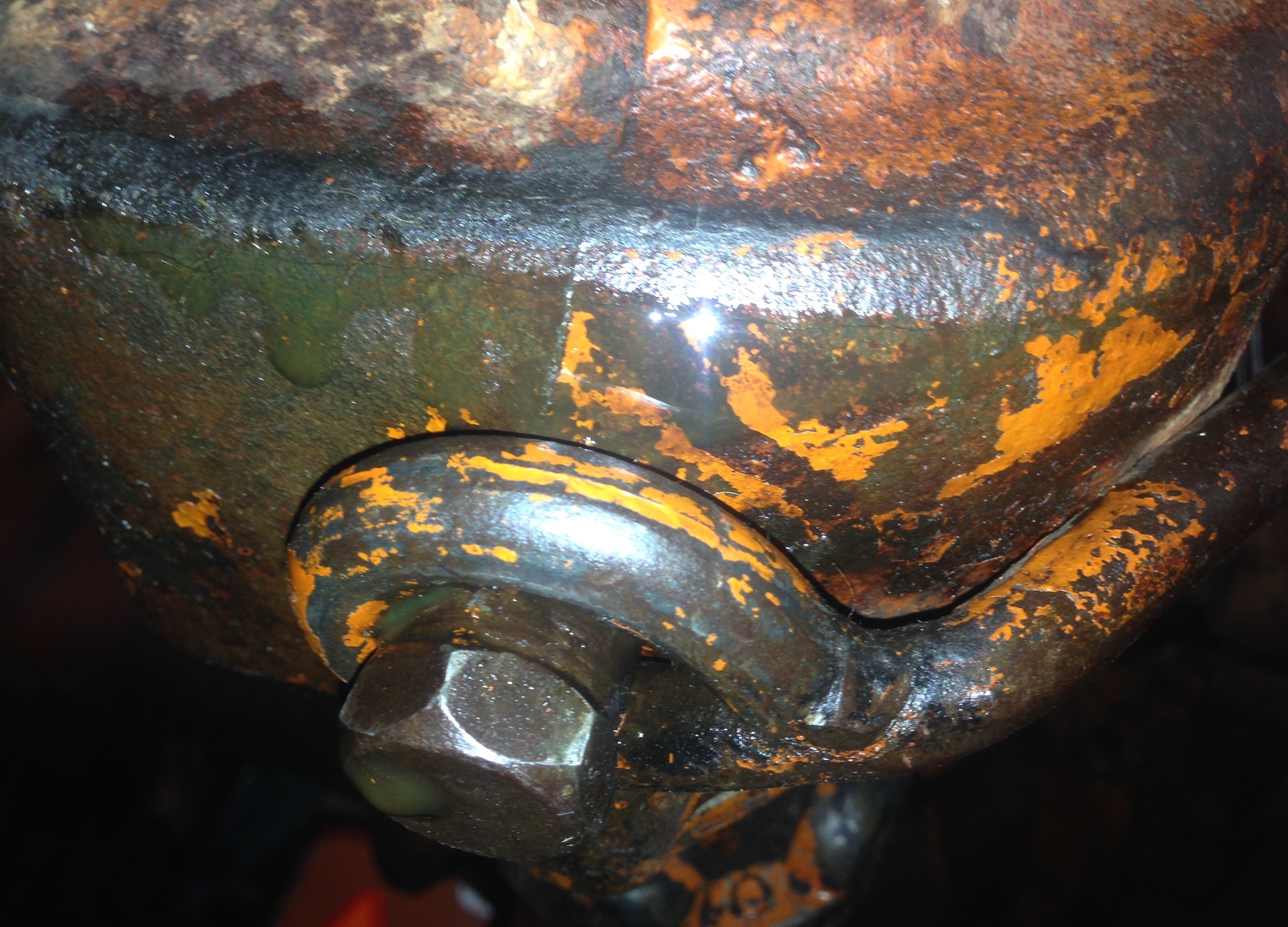

Thinking about Vee out the crack then weld with Hobart cast rods. Have any of you seen these crack in the front like this before?
Replaced the PTO lever seal because it was leaking only to walk in the shed today to see it still dripping.

weld her up mine is welded also

I have seen several with the same crack up here in northern MN.  Over time water gets into tranny and the pto is the low spot, winter comes and you have a crack.

I welded one myself 20 years ago. Worked out pretty good. And yes, that is in Minnesota.
