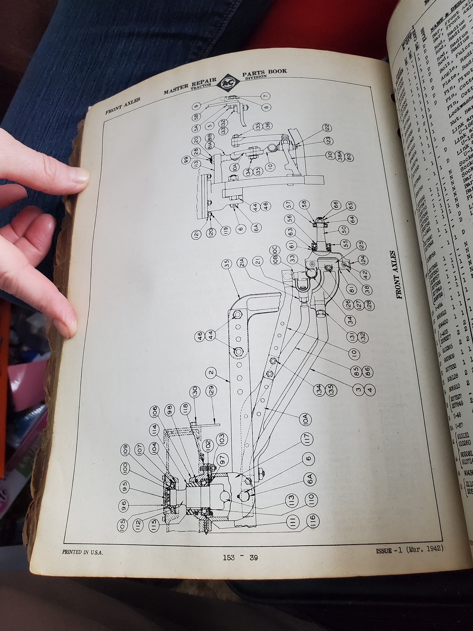

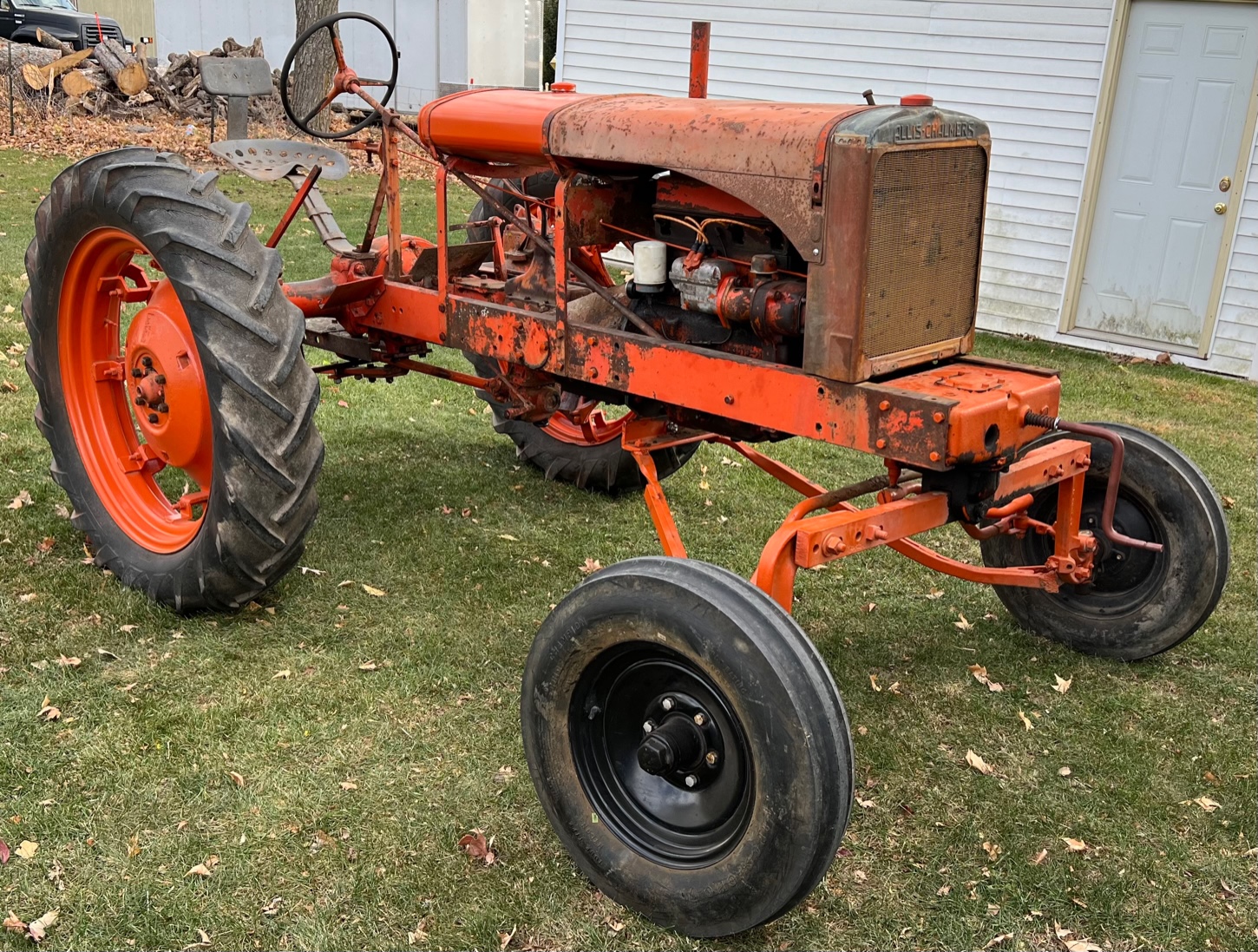

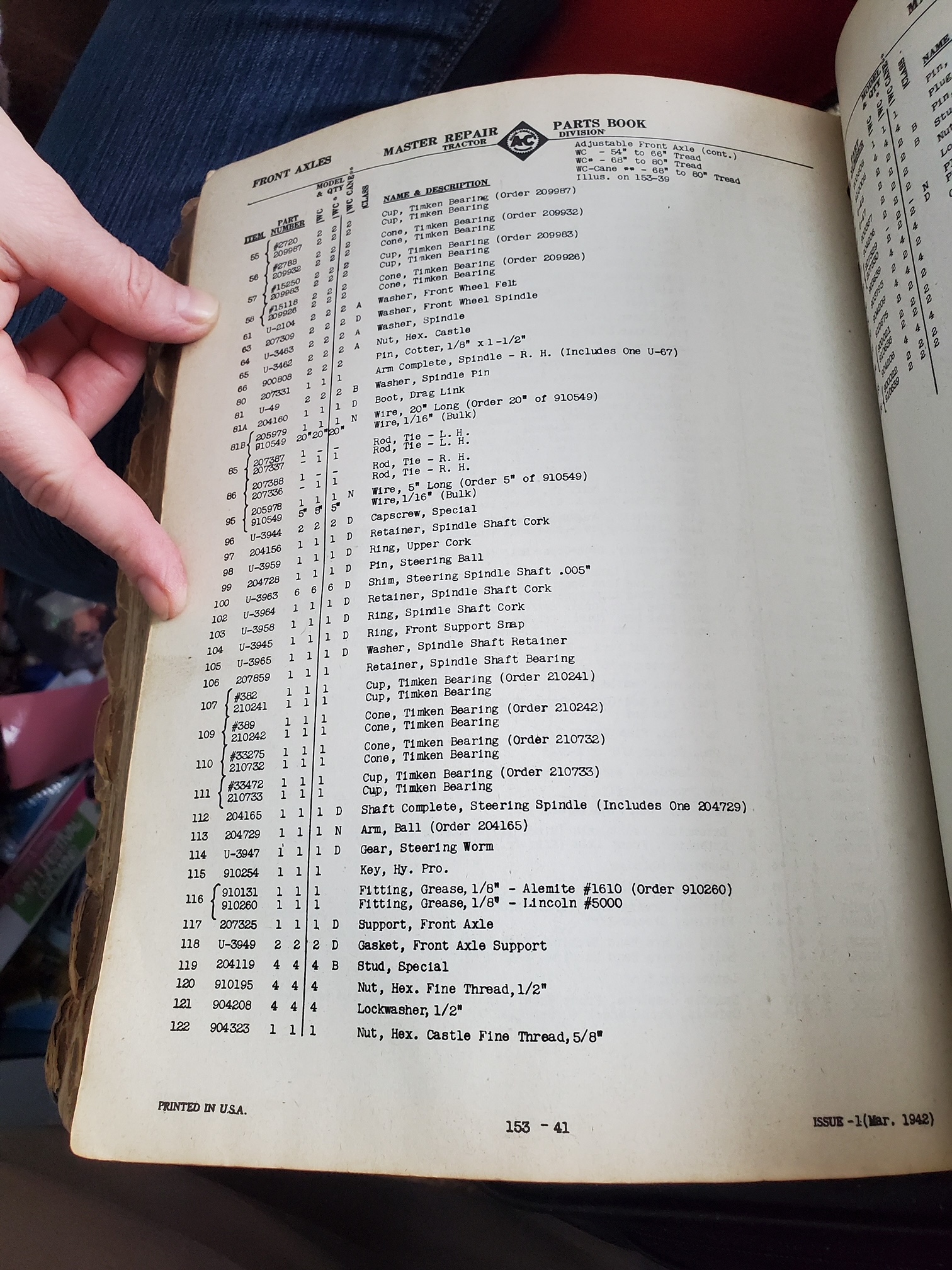

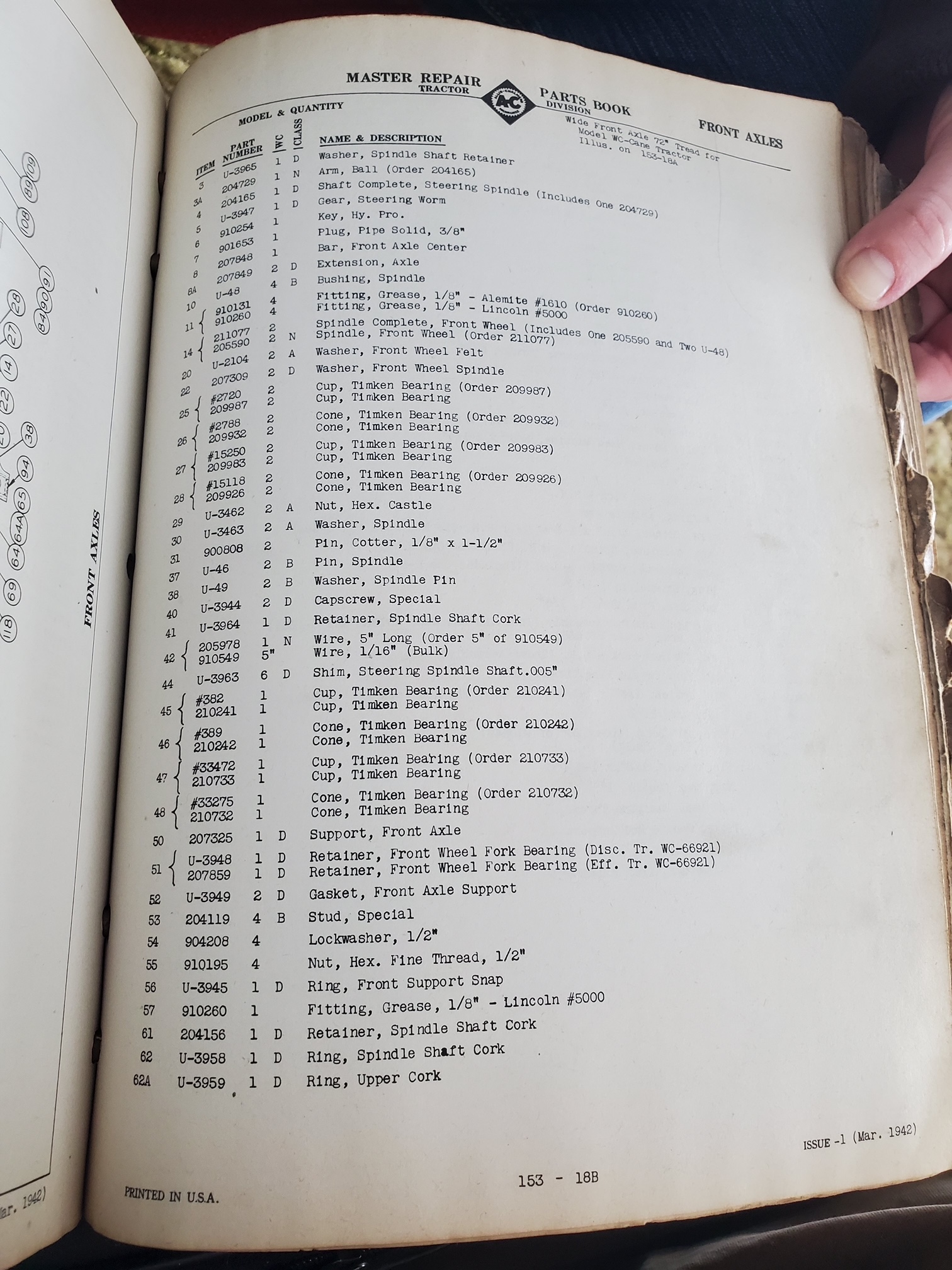

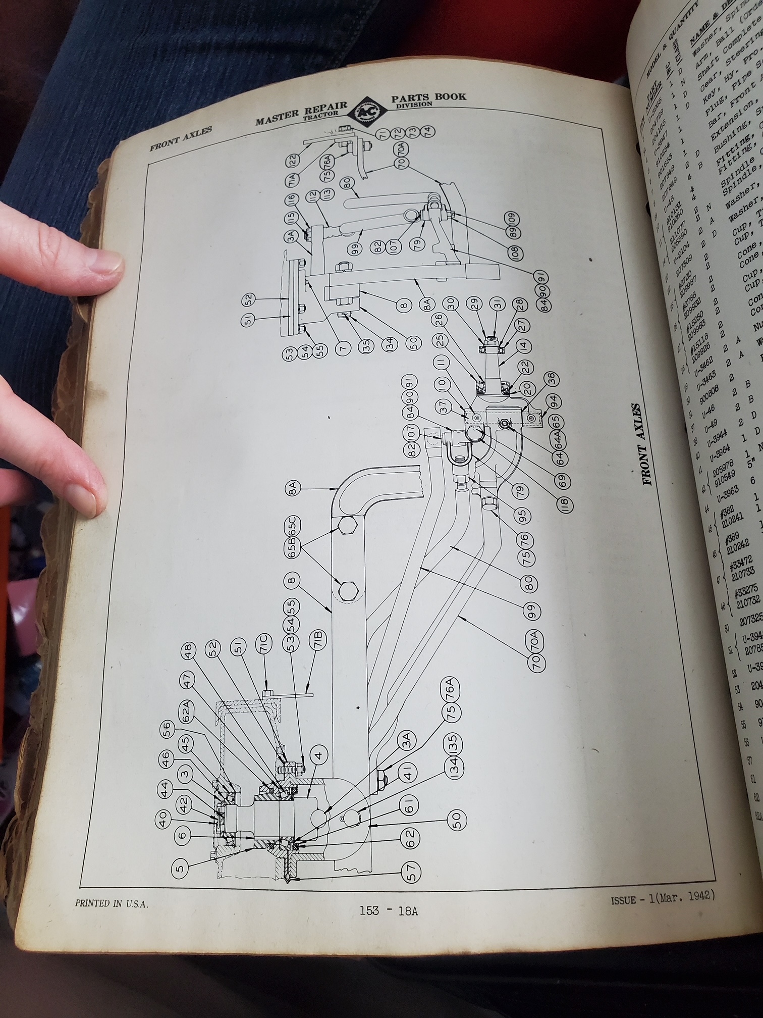

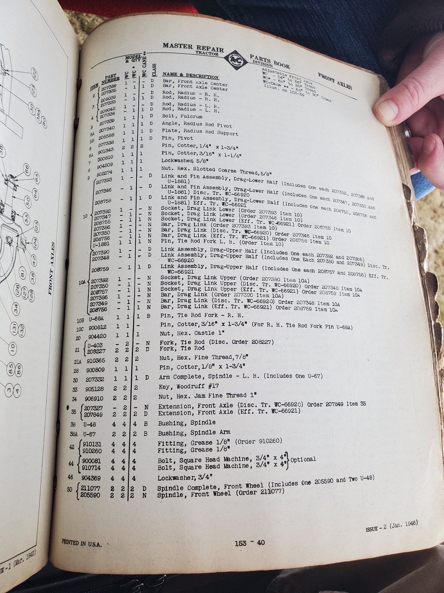

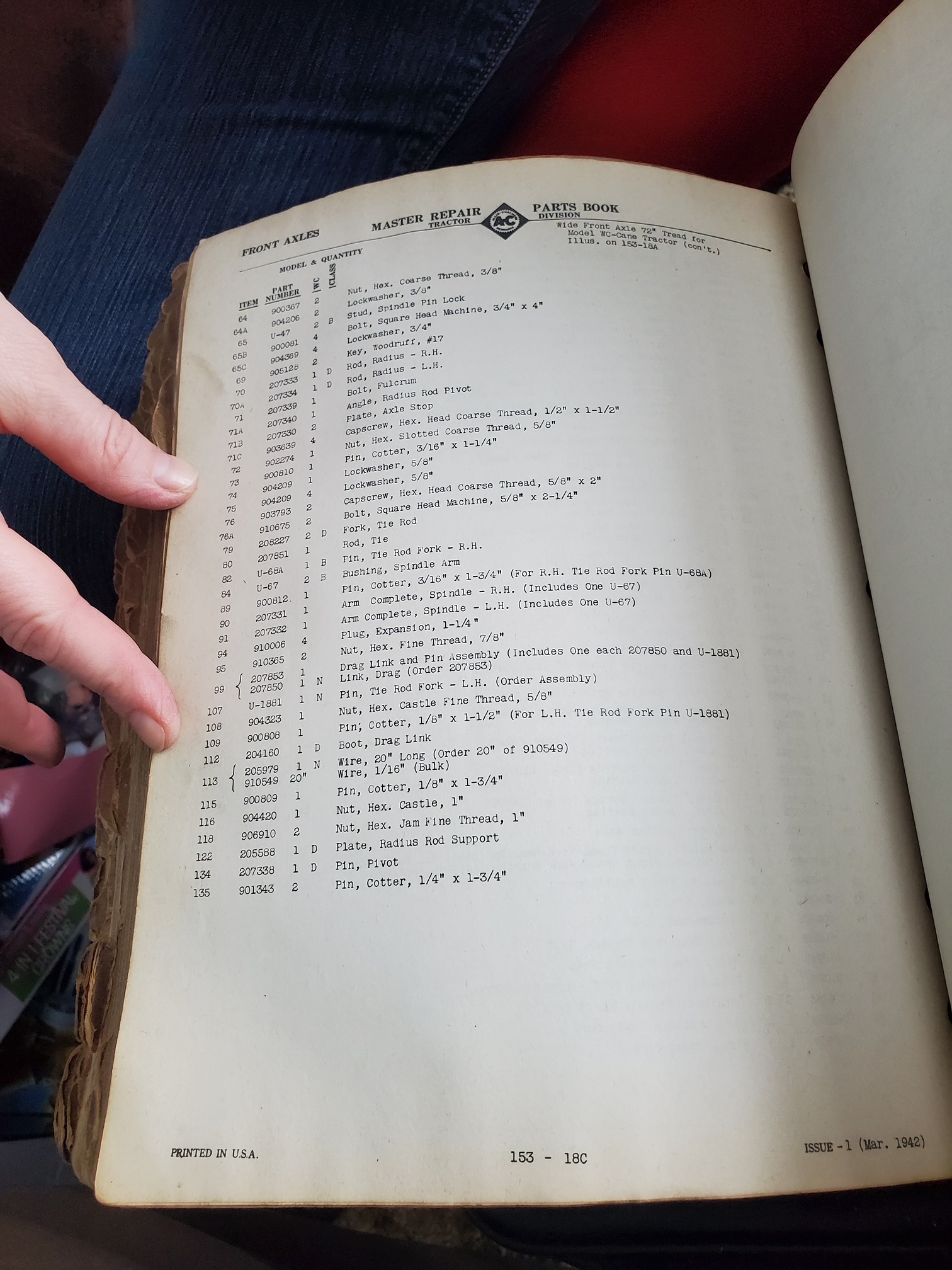

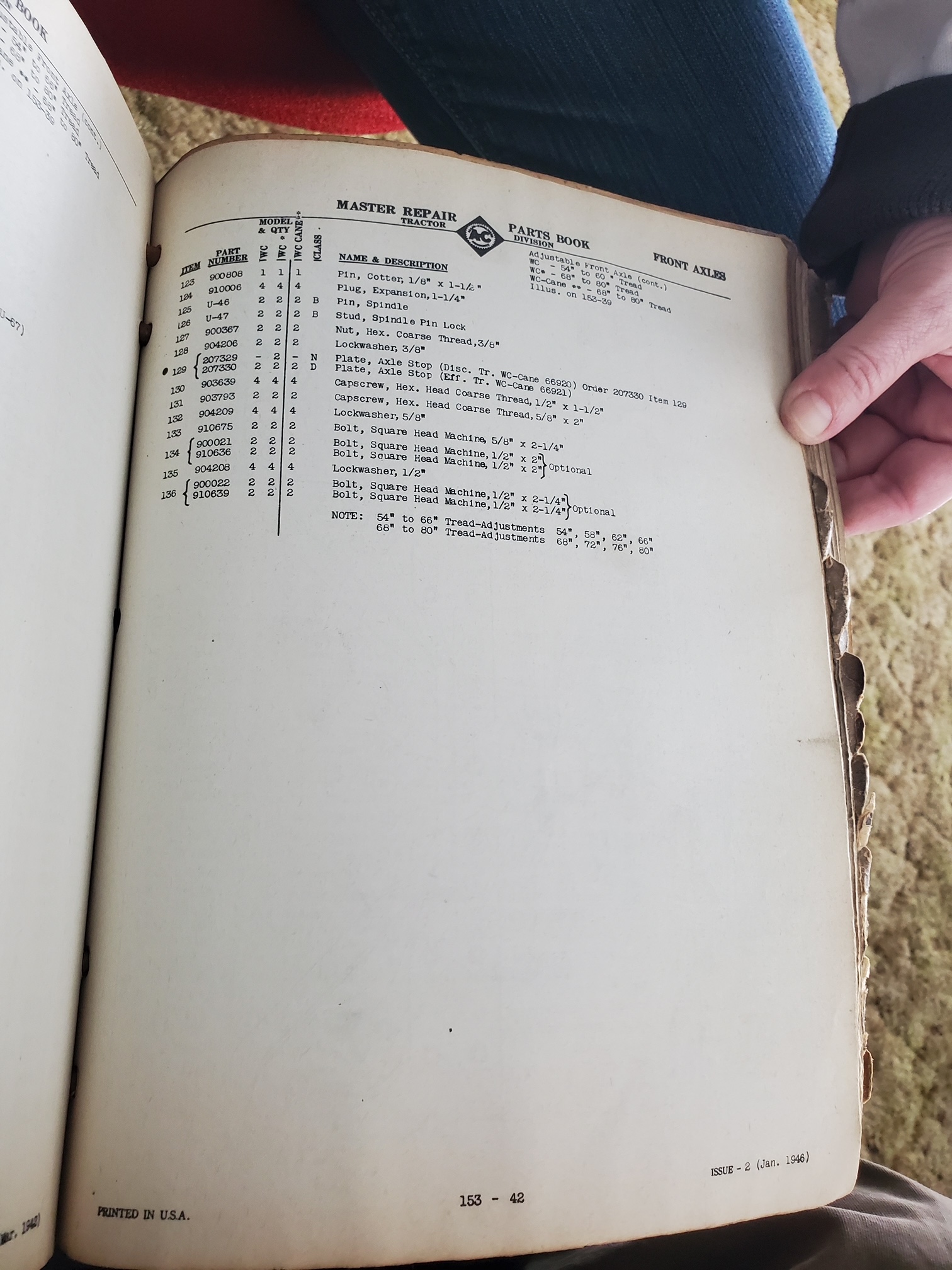

I have a 1938 WC high crop/clearance tractor I'm working on. I'm looking for more information on it. The front end is the early adjustable style with the taller spindle knees. This early style front end also uses a drag link and tie rod set up instead on the later left and right tie rod assemblies. These tie rods and drag link have been made non-adjustable during a previous repair. Does anyone have better pictures showing what they should look like? These can be from parts books, original photos from the cane fields or tractors that have been hauled out in the past. Also looking for a rough idea of how many were made and who actually made this front end. There are no thomson branding on any of the parts that I've seen. Attached are some pictures of the tractor and the parts book I have. Yes I'm aware that they are suppose to have WF front wheels and the rear wheels have spacers that need removed still.Displaying IMG_6052.jpgDisplaying IMG_3151.JPGDisplaying IMG_3152.JPGDisplaying IMG_3153.JPGDisplaying IMG_3154.JPG

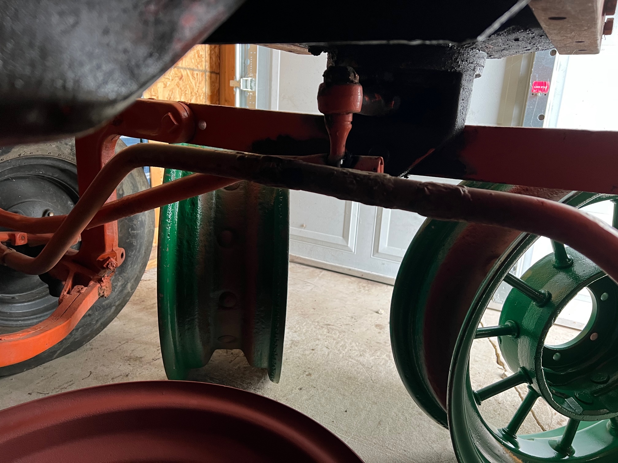

Here are some pictures of the parts in question.Displaying IMG_6364.jpgDisplaying IMG_6365.jpg
