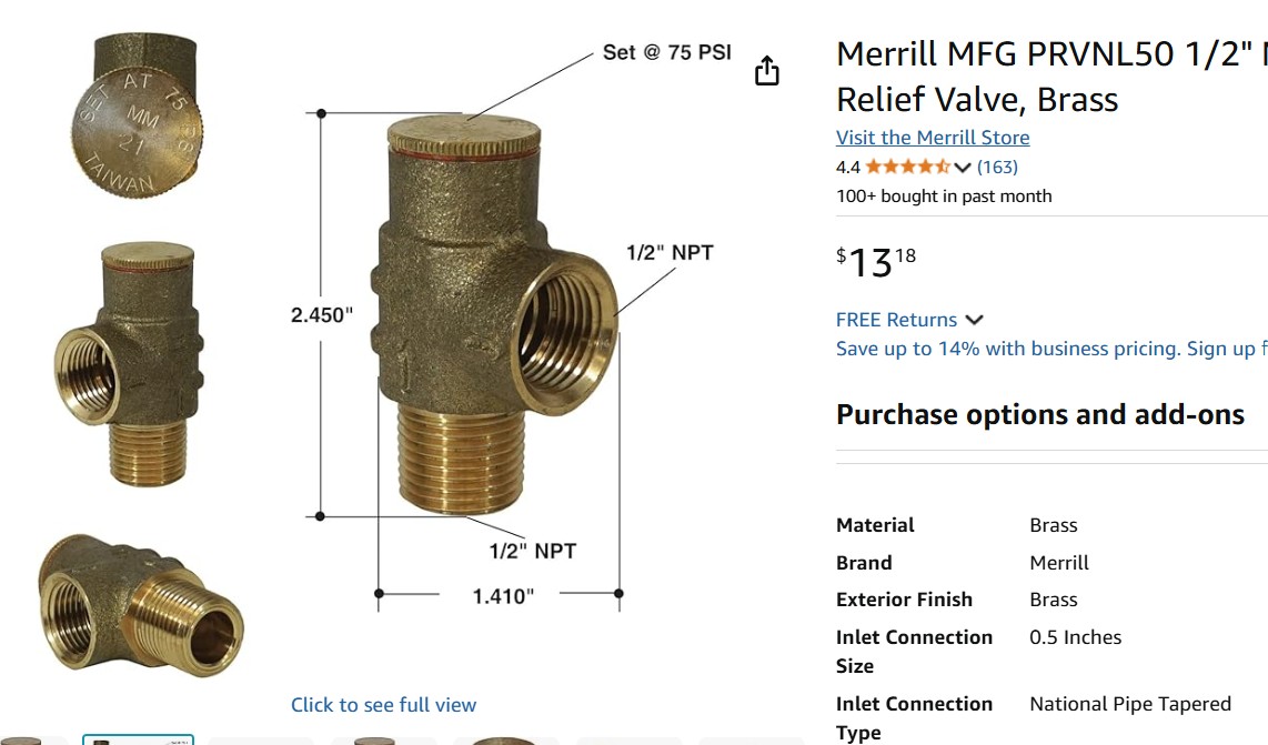

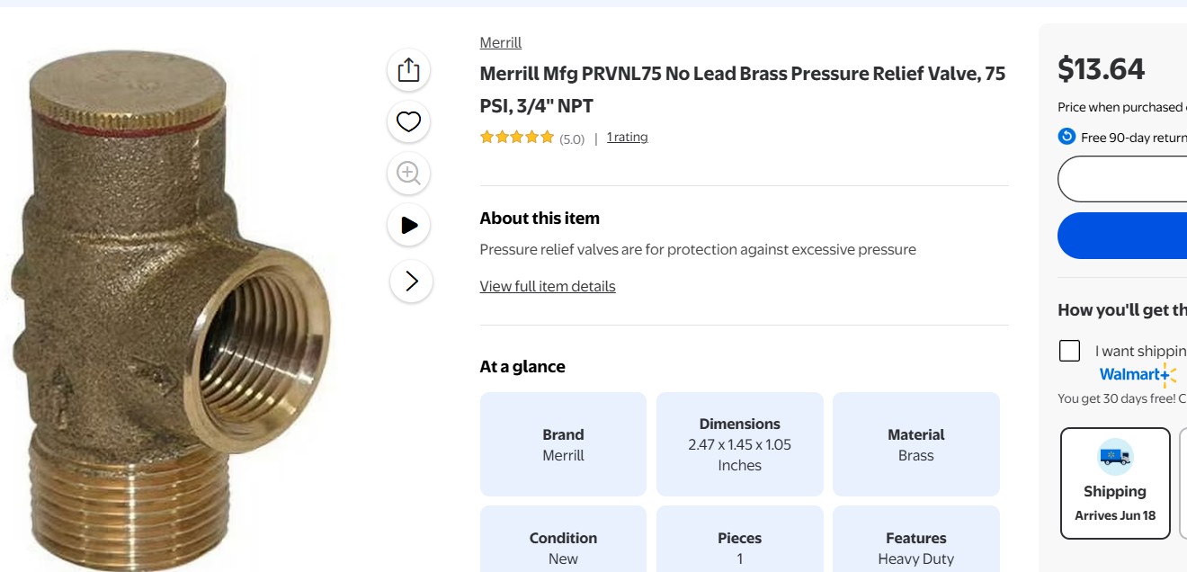

sounds like a plan.. TEE into the discharge...a RELIEF VALVE that opens and dumps back to the creek or suction side... you dont want to REGULATE the pressure, you want to DUMP the water when pressure reaches 50 psi...
something like this at WAL MART... dont know what your pump PSI is capable of ??

Hay Steve , yeah that's what I want ! AmazonCanada has it... $45.00 !!!!
oh well, I'll keep looking NOW that I know what to look for !
THANKS.

Post Options Post Options   Thanks (0) Thanks(0)   Quote steve(ill) Quote  Post ReplyReply Direct Link To This Post Posted: 16 Jun 2025 at 9:33am
$45. in Canada ???  GEES , you could drive across the border , go to Wal Mart, and SAVE MONEY !!   Clap.....................    really... you cant order from Wal Mart ?

a variation at AMAZON...

No the RV thing magically reduce pressure to 45PSI. Not what I need.
Have ordered a PRV that'll recirculate the water from 'out' to 'in' when the nozzle  is shut off.
