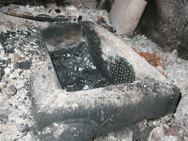

ChuckLuedtkeSEWI View Drop Down
Location: Jackson, WI
Points: 1826
Post Options Post Options   Thanks (0) Thanks(0)   Quote ChuckLuedtkeSEWI Quote  Post ReplyReply Direct Link To This Post Posted: 09 Feb 2011 at 7:42pm
Here is a link to someone who built a Roger Sanders design one and all the things he figured on the way.  Fairly decent writeup with some good pictures.   I have always wanted to make one but like all projects, I don't have the time to get to them.

Post Options Post Options   Thanks (0) Thanks(0)   Quote Brian Jasper co. Ia Quote  Post ReplyReply Direct Link To This Post Posted: 10 Feb 2011 at 9:50pm
That makes more sense with the pics from the waste oil stove forum. I don't like the oil bucket up on top of it. Unless you had some kind of pump, filling that bucket could be messy.
