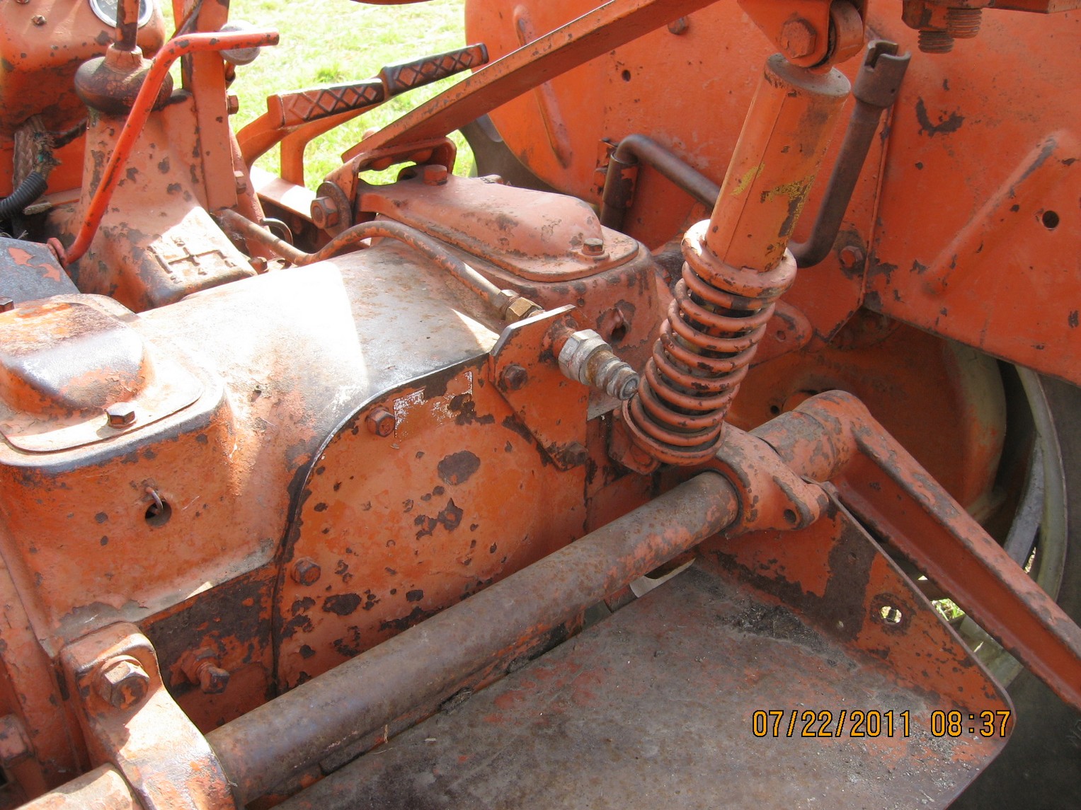

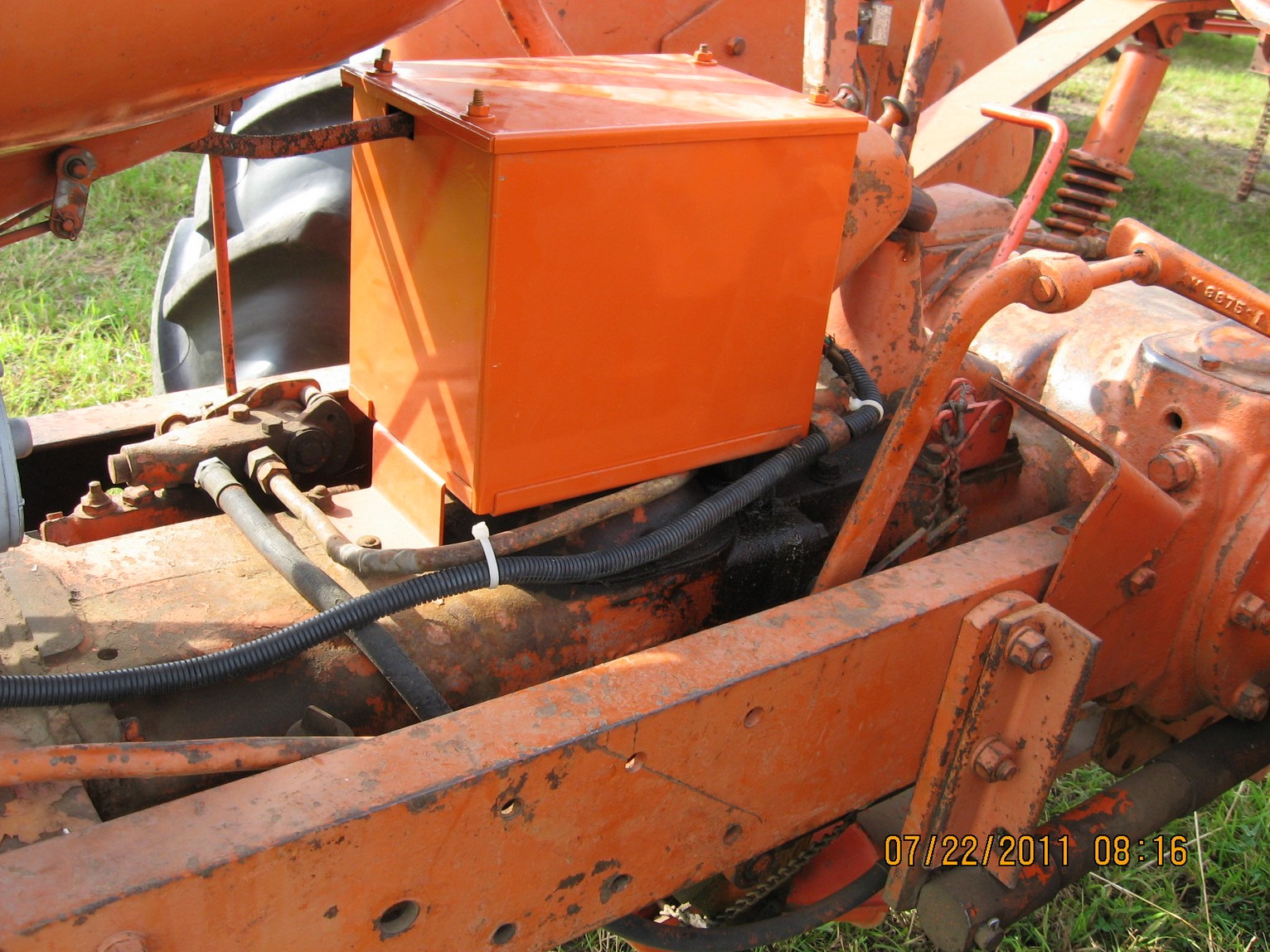

Post Options Post Options   Thanks (0) Thanks(0)   Quote hardwood61 Quote  Post ReplyReply Direct Link To This Post Posted: 25 Jul 2011 at 8:22pm
Thought I'd post a picture of an auxiliary hydraulic set up on a WD - I was at the Orange Spectacular in Hutchinson this weekend and took some pictures of tractors with this setup so I thought I'd share, just in case there are some others out there that had never seen a aux setup before ... like me.  The stock aux line is closest to the battery box and runs under it and to the back - see pictures.
uploads/3420/IMG_0117.JPG
uploads/3420/IMG_0118.JPG
