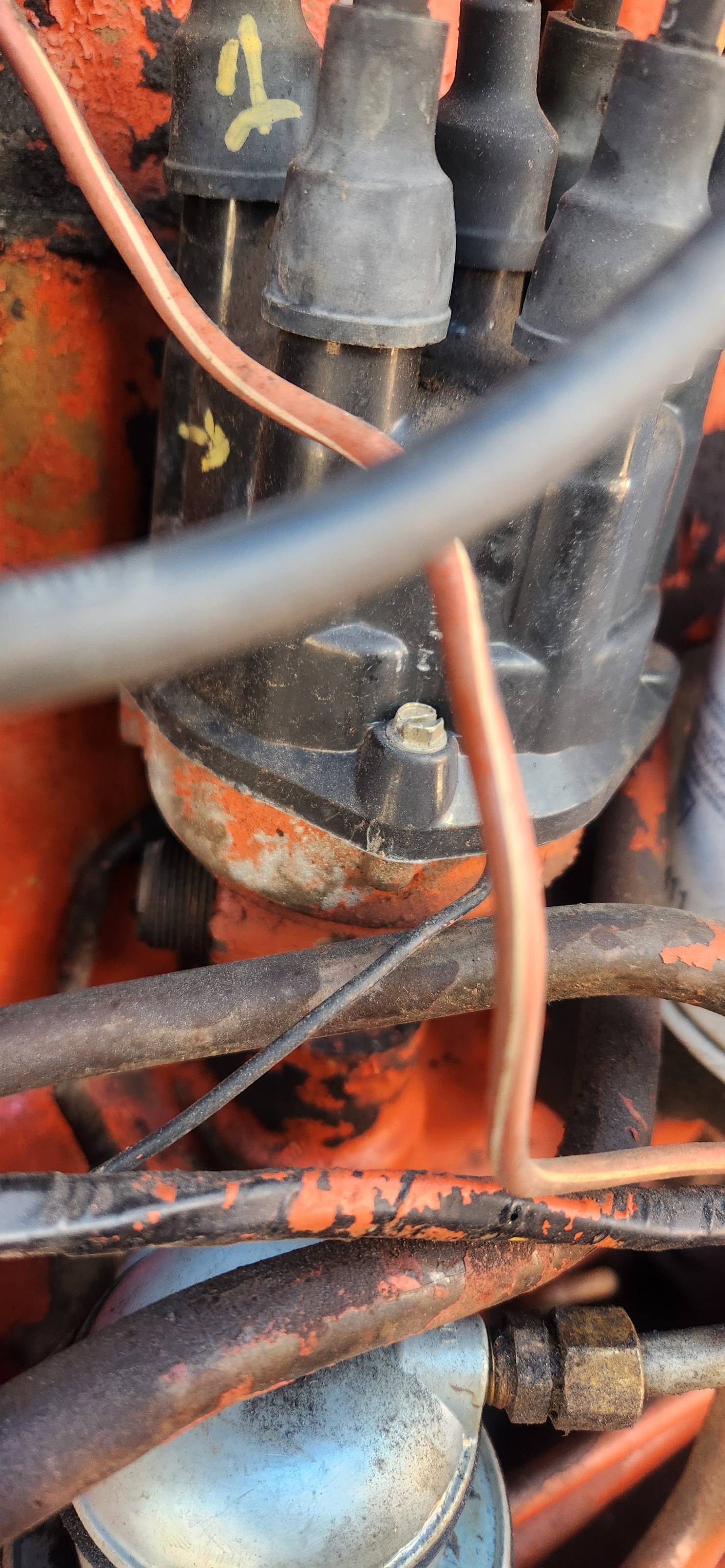

For some reason my distro is 180 degrees off, so my tach drive isn't facing the right way. I "should" be able to turn it in increments of 60 degrees as long as I change which sparkplug is plugged where, right?
Or do I need to pull it completely and turn it and retime?
I will be timing the motor regardless, but I dunno really want find TDC.

Post Options Post Options   Thanks (0) Thanks(0)   Quote MadCow Quote  Post ReplyReply Direct Link To This Post Posted: 14 Jan 2026 at 3:30pm
Sorry, 190xt

normally people want the #1 plug wire in a specific location.. if you dont care, then yes you are right.. rotate the distributor and cap 180 degrees and move the wires the same... It all depends on where the ROTOR is pointing and it will move 180 degrees with the distributor.

This much, I know. The distributor rotor/shaft cannot be turned 180 degrees. It only fits in the engine one-way, not two ways. So, with that in mind, proceed.

Tach drive was forward on all 190/XT gas tractors as far as I know.

Post Options Post Options   Thanks (0) Thanks(0)   Quote MadCow Quote  Post ReplyReply Direct Link To This Post Posted: 15 Jan 2026 at 9:35am
I can't imagine the drive cable is supposed to point forward and turn around a 180 degree bend to the tach, that would cause significant wear on the cable. But I don't know for sure. It's also angled too close to the block cable physically won't screw on. So I would at least need to move 60 degrees.
The rotor/shaft won't be turning, just the housing and cap, so I shouldn't have issues with that.
The #1 spark plug wire will be in a different hole in the cap, but will be in the same place relative to the rotor. The same absolute place in space.

If someone has an Owners manual to an early 190/190XT, I'm sure there is a picture of the left side of a gasoline engine and that would verify how things were positioned. The later model tachometers were driven by the alternator.

Looked through, only shows the diesel left side.
