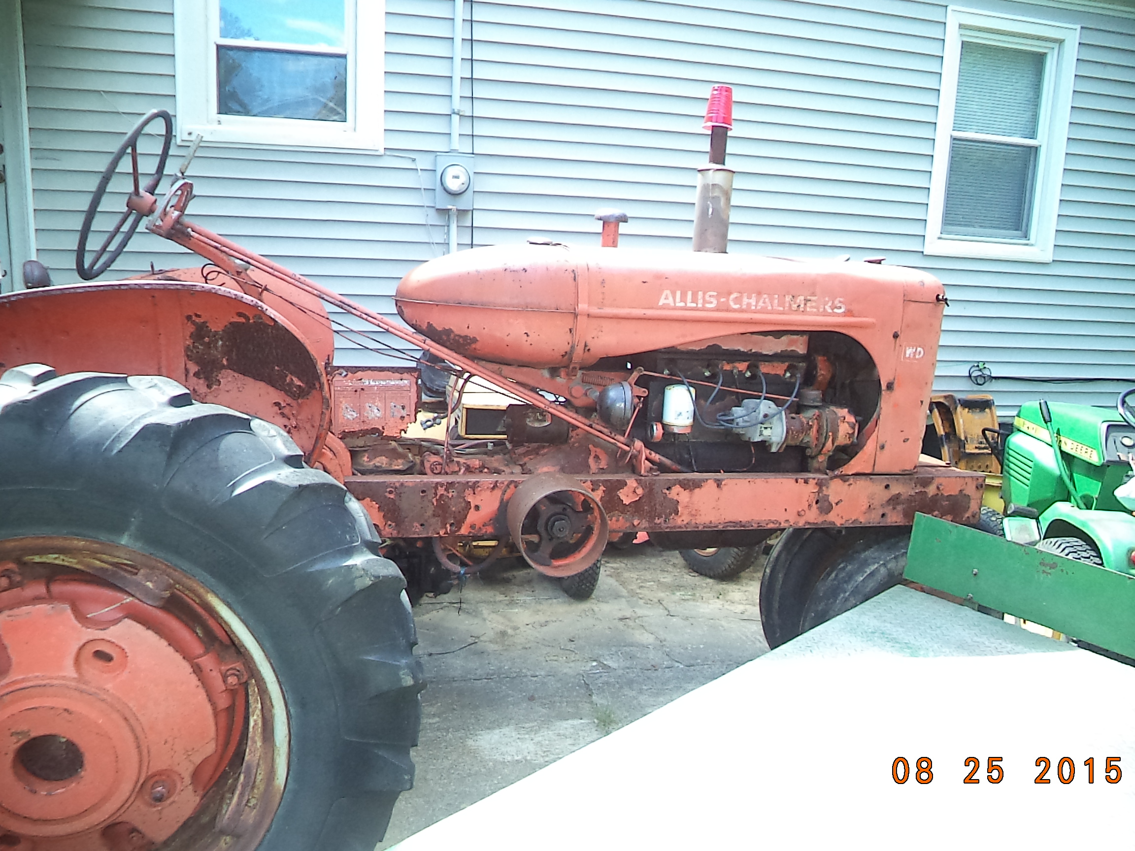

Just recently got my Grandpa's WD running again after it had been sitting for over a decade. Actually running pretty decent as is but I still think it could use some finer tuning to smooth it out more. I cleaned the carb myself, albeit crudely, with just some carb cleaner and compressed air before putting it back together with new needle valves and a couple new gaskets. Set the needle valves on the carb per the manual. Tried reviving the mag myself too but never had any luck getting any spark so I splurged for a "new" professionally rebuilt mag which I then installed per the manual also. The new mag is currently installed centered within the adjustment slots. That was good enough to get her to start even with just the hand crank only and drive her around the yard under her own power for the 1st time in over 10 years. Boy, was that ever a thrill!!!
NOW, I'm planning to do a little fine tuning the next time I get her running BUT before I get to that, I thought it might be a good idea to ask for any input from those of you with more experience than myself in regards to just where I should start. Do I adjust timing with the mag adjustments first and then tune in the carb better OR vice versa OR doesn't it really matter which I do first?????? TIA folks.
