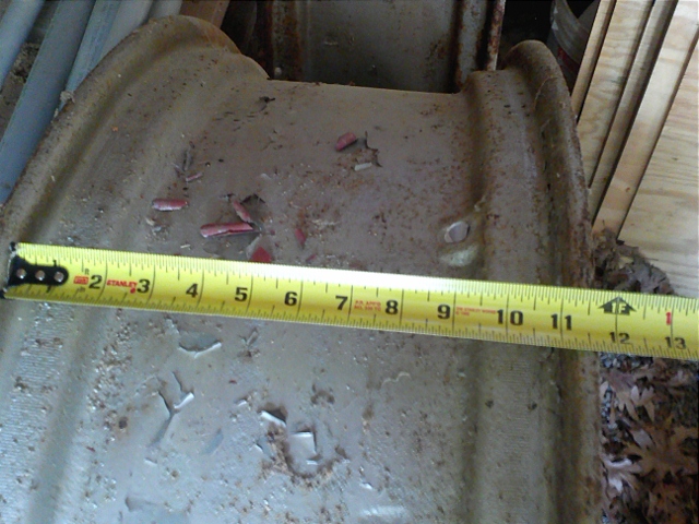

I have a 1961 D-15 Hi-crop tractor (s/n: 3801). I am getting ready to purchase new 12.4-38 tires for my 38x11" rims (see photo). These are not the current wheels on my tractor.
I'm trying to determine if I need to purchase tubeless or tubed tires. Are these rims compatible with tubeless tires? I'd prefer to go tubeless if possible.
I am planning on sand blasting and painting the wheels before adding the tires.

If your rims are solid and not rust pitted from being fluid fill tubeless tires will work without problems. Give your rums a good close look after sandblasting before you repaint them and spot weld any holes that might appear.

check the hole size where the valve goes... Make sure you get a valve that FITS.. or you might have to drill the hole alittlel bigger..
