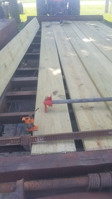

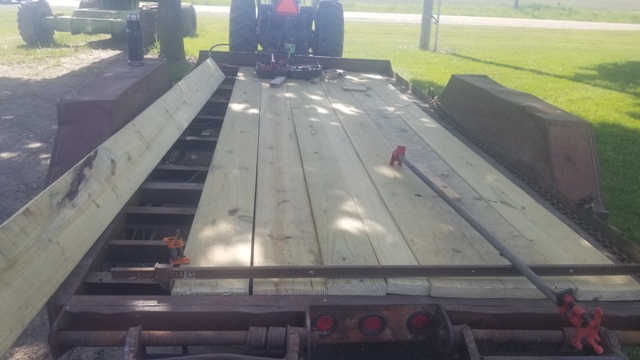

This is my skid steer trailer I'm decking today. The boards were purchased from Menard's less than a month ago and they are twisted and curled badly. I loose layed them on the trailer after stripping off the old and used the trailer a couple of times but today started to straighten them back out using the trailer as the platform.
Loose laid boards with the worst one shown with clamp setting but no pressure applied:
Same with clamp tight and just starting to deform the edge from the applied pressure. Second clamp, (Pony) is applying downward pressure removing "twist":
Porto power shoving on the other end to align it. Again the pressure is just enough to start to crush the boad edge:

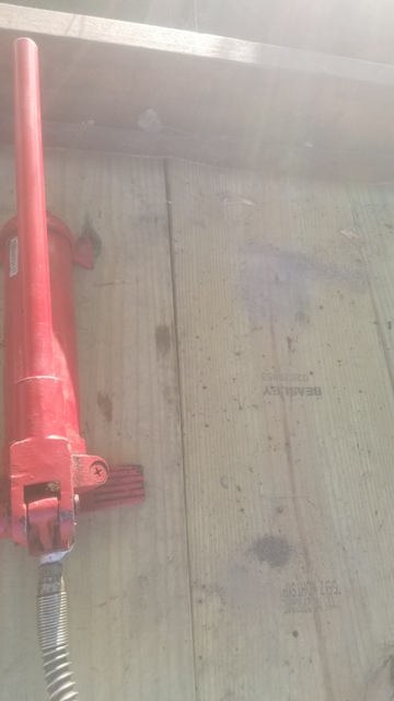

Allowed to dwell for just over an hour and gave the clamp and porto power some additional force as board is relaxing:
Going to allow an overnight set and will see the results tomorrow morning. There is one more board shown here that is minor but is twisting. This will remove easily:
I have a trough out back I can stack lumber in and fill this with used engine oil. I may do that later when the boards have dried out. I'm putting this deck down with semi trailer decking screws and they both install and remove easily. Hopefully have this task wrapped on Monday as have a small excavator to bring in for service.

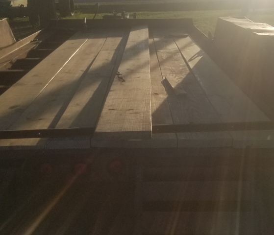

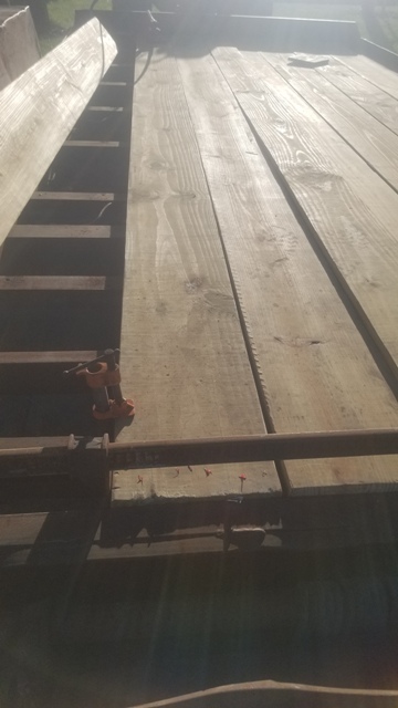

Post Options Post Options   Thanks (0) Thanks(0)   Quote Codger Quote  Post ReplyReply Direct Link To This Post Posted: 09 May 2025 at 10:21pm
These were arrow straight when I purchased them, but wet. Had planned to install very shortly after bringing them to the shop but had paying jobs make entry so this got shoved to the back burner. I had stacked them on my old Mack truck frame with a spacer board perpendicular to allow air to dry them out and they are much dryer than original but a couple have taken to changing shape.
Ran out just before dark and gave the clamps another twist, and the porto power another tensioning. The boards are now all shoved together tightly. I'll let this go till morning and then hopefully they will be close enough to do as you stated and force them together while fastening down.
This trailer has a strip of steel welded to the bulkhead at the front but nothing at the rear except the edge of the 6" channel that is the closing panel. Prior to my ownership 23 years ago somebody bent this channel and I've got to straighten it before the deck boads will fit in the area. I cut all of them even and will use the skid steer and hydraulics to pull it out tomorrow. Also need to do some straightening and welding on the hinged ramps. Like the trailer a lot but rust is just about to put it down. Even the 2X6X3/16" wall tube frame has holes rotted in it, but nothing structural yet.

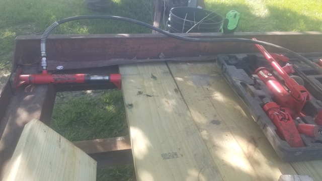

Post Options Post Options   Thanks (0) Thanks(0)   Quote Codger Quote  Post ReplyReply Direct Link To This Post Posted: 10 May 2025 at 4:50pm
Didn't take my phone with me this morning but the clamping did pretty fair on straightening the bent 2X10. I also put the 4 ton porto power against a tube xmember I welded in years ago for hauling forklifts and pushed the tailboard back out so it is now relatively even full width across the rear. I built up another couple of clamps and now have a pair on each side of the trailer. With the boards pulled tightly against one another, the remaing open space between them is 11.5" so going to run back to Menard's and purchas a 2X12 and leave everything forced together tightly. Also found a piece of 2X2X1/8 equal leg angle steel to make the closing panel across the rear. This will disallow the board edges from peeling off when something comes in contact with them. The boards do not set flush with the structural steel but rather are elevated about 1/4".
I'll finish this task tomorrow afternoon and move onto something else.

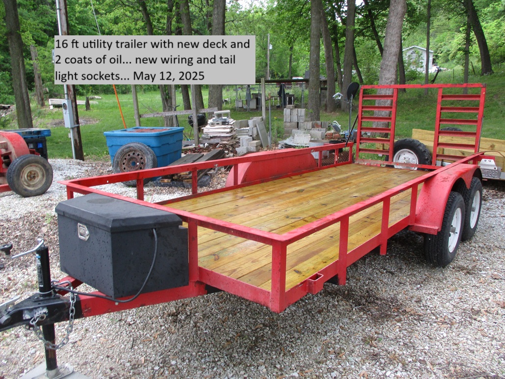

Post Options Post Options   Thanks (0) Thanks(0)   Quote steve(ill) Quote  Post ReplyReply Direct Link To This Post Posted: 14 May 2025 at 9:09pm
finished this a couple days ago... Pressure treated with 2 coats of used oil after letting boards dry for a month..
