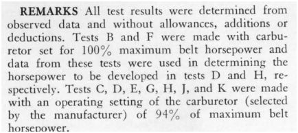

Another thing to take into consideration, is the carb setting for the test in question. In this case (E) it's 94% of max HP.
Edited by frnkeore - 09 Jul 2019 at 11:53am
