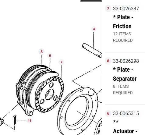

Here is a photo. Reference #7 is the friction discs, reference #8 is the steel, or separator discs. Set up much like an automatic transmission but manually applied.

This subject got me to thinking so now have a better understanding of how these brakes actually work. I really couldn't envision how each side had six 7/8" steel balls in the brake system. By dissecting the literature I've had access to, I now see the apparatus and can see how it functions. I can also see the wear points over time in the system.
