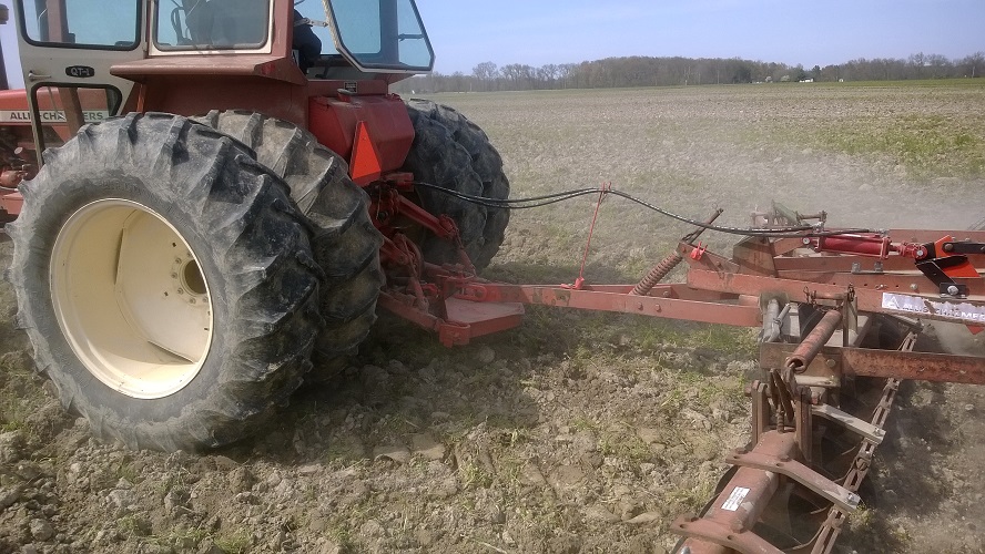

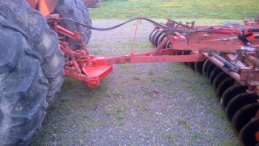

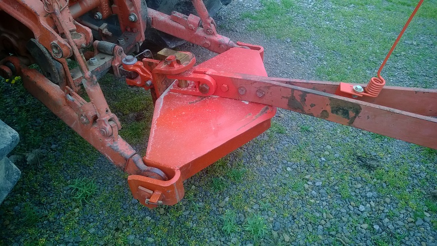

Here are some photos of the TB Drawbar we had on the XT.  Remember that the tractor drawbar needs to be un-pinned under the belly, so it floats fore and aft.  The pull of the implement will be on the lift arms.
Use the TB position on the lift arms lever.   This allows the arms to lift as the load increases as the implement pulls on the lift arms.  Use the Traction Booster Lever to control this amount.  This is what transfers some of the weight of the implement to the tractor to gain traction.
Position Control MUST be set to allow arms to be all the way down.  Put in place some mechanical lockout device to make sure the PC lever cannot be moved.  Also affix some mechanical lock out type device on the console so the Lift Lever cannot be moved to the Raise position.
The setup of the position of the front clevis will depend on the geometry of your tongue and other factors.  There must be enough slop in the drawbar pin/clevis to allow for the hitch assembly to raise up and down a bit without binding.  The clevis in the photos has an Oval hole to allow for this.
The Doctor is probably correct that the plunger in the valve body was not free to move out once it was forced into the body.  This plunger must move freely.

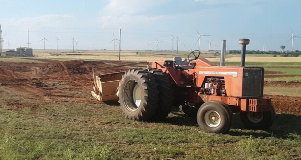

Thanks guys.... I'm going to give it a go again. I think it might help pulling this 7 yard Rowse scraper.

gee you'd think all them windmills would blow the dirt to the right spots !Wink
CALEBnOK View Drop Down
Joined: 12 Nov 2011
Points: 618
Post Options Post Options   Thanks (0) Thanks(0)   Quote CALEBnOK Quote  Post ReplyReply Direct Link To This Post Posted: 05 Jun 2020 at 1:23pm
Storm blew in last night and my wife said the motocross track was going to blow away
