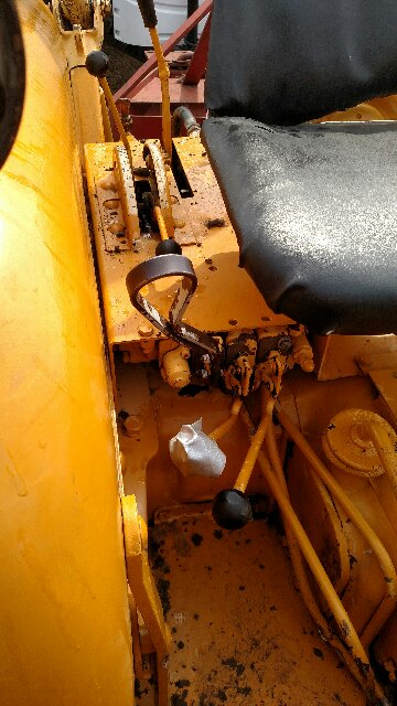

As this is my first tractor I am sure this is only my first mistake.   So far I have got a lot of use out of it.   We are building a house and the front loader has been a real back saver.   To have the 3 point functioning with no traction boost I need to make sure I have all the levers in the right position.   Front what I read the two traction boost levers should be in the full forward position. I have 3 levers next to the seat.   I think this tractor had a side sickle and backhoe option at one time.    A lot of lines with fittings not connected. the three levers next to the seat I am sure the large loop handle is the up and down for the 3 point.   The one with tape on it will send fluid to a fitting that is capped off. I know that as the fitting leaked and it shot fluid out when we hit it.   Sealed the leak and marked that one as Do Not Use.   These two valves have multiple detents and I am sure there is a proper position for all these to allow the large loop handled valve to just move the 3 point up and down.   As we only plan to use the 3 point for the back blade and move a trailer around I will plan on leaving the traction boost disconnected for now.   Any help on what position everything needs to be in would be helpful. Or any photos under the rear on things should have been connected prior to the linage breakage would also help.
KenJ View Drop Down
Joined: 03 Feb 2017
Points: 14
Post Options Post Options   Thanks (0) Thanks(0)   Quote KenJ Quote  Post ReplyReply Direct Link To This Post Posted: 01 May 2017 at 8:30am
Here is a photo of the levers next to the seat.
Points: 22811
Post Options Post Options   Thanks (0) Thanks(0)   Quote DrAllis Quote  Post ReplyReply Direct Link To This Post Posted: 01 May 2017 at 8:39am

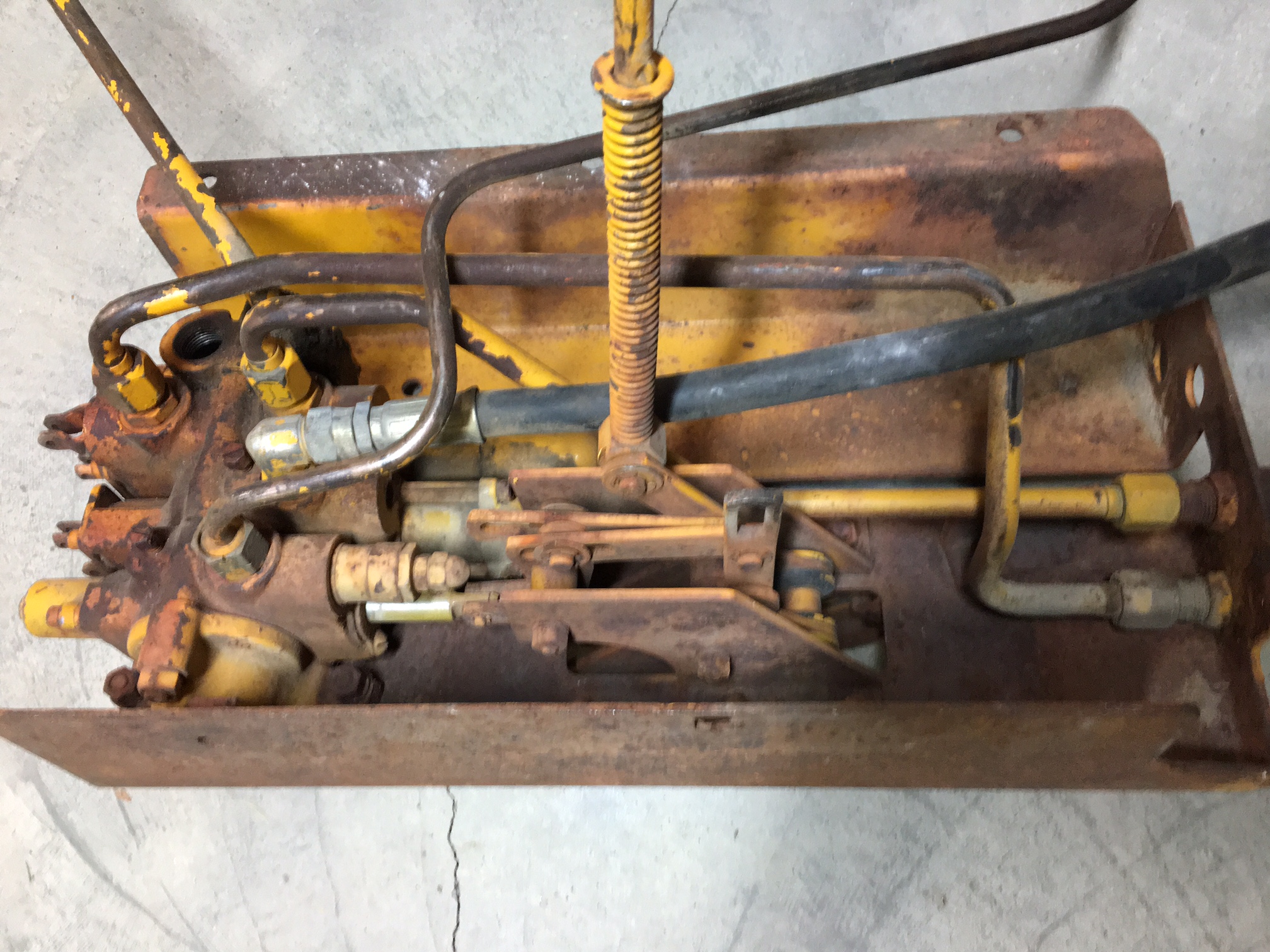

OOpps!...I thought we had the 170 style console...
JoeO(CMO) View Drop Down
Location: Cent Missouri
Points: 2696
Post Options Post Options   Thanks (0) Thanks(0)   Quote JoeO(CMO) Quote  Post ReplyReply Direct Link To This Post Posted: 02 May 2017 at 4:03am
Under the plate the end result is the same, just a few different parts.

Oops, uploaded as wrong size
KenJ View Drop Down
Joined: 03 Feb 2017
Points: 14
Post Options Post Options   Thanks (0) Thanks(0)   Quote KenJ Quote  Post ReplyReply Direct Link To This Post Posted: 02 May 2017 at 7:37am
Thank that helps.   I hope to check it out soon. The weather here has been bad for days.

Post Options Post Options   Thanks (0) Thanks(0)   Quote KenJ Quote  Post ReplyReply Direct Link To This Post Posted: 09 May 2017 at 5:11pm
Thanks to everyone for the help.   As I said a bracket had cracked a weld and the traction boost lever was not operating the valve.   The picture helped and we were able to reach up and active the valve by hand and the 3 point now works again.   So happy I can use my drag blade.   Looking forward to a lot of back saving work on the property.
