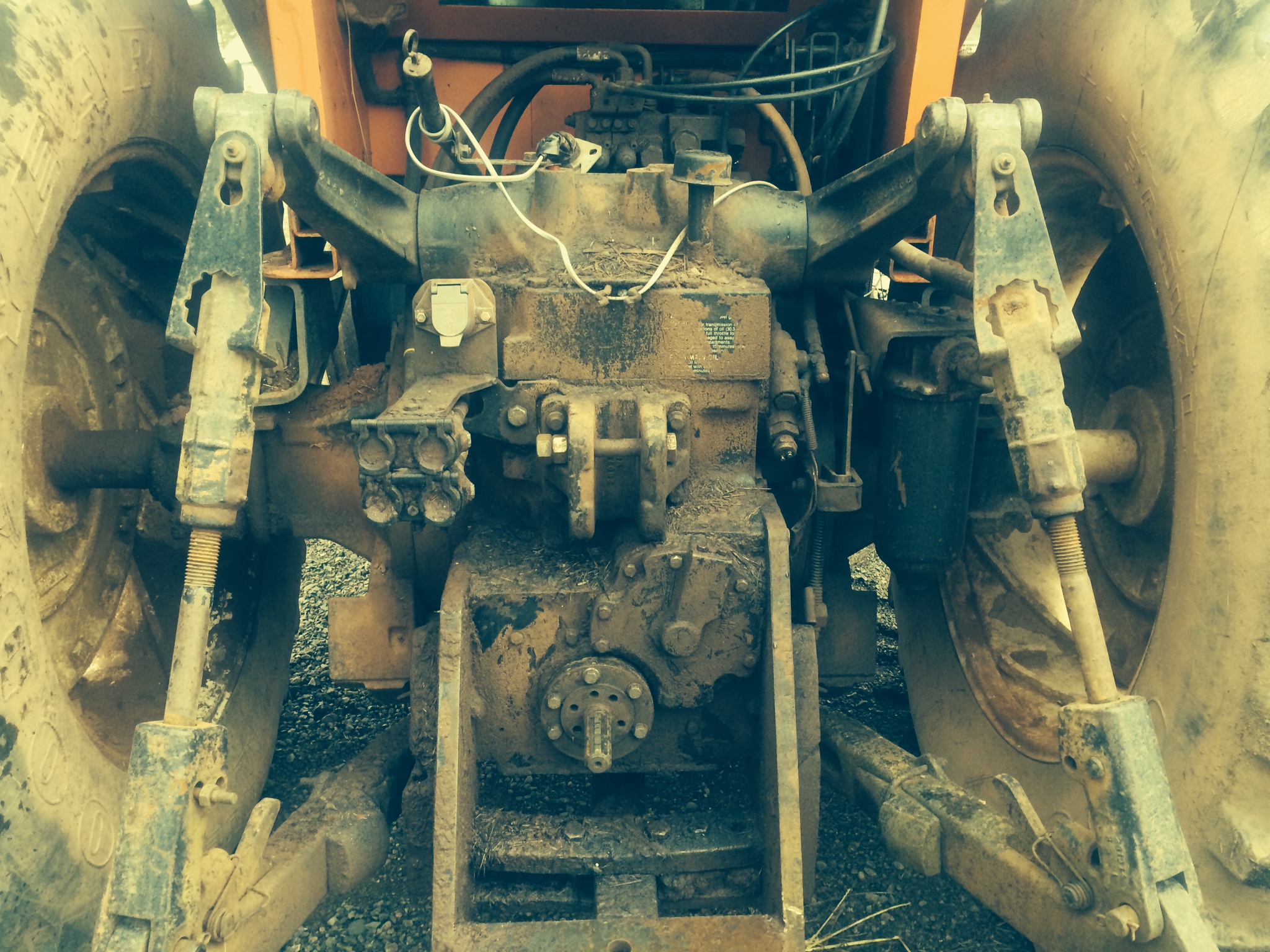

Hi, new member here, never been around AC equipment but an 8030 powershift, 2wd with under 2000 hours was advertised close to me and I think it would be ideal to leave on the discbine all summer.  The asking price is 7000$.
Its for sale by a jockey who bought it at auction recently, it was used at a construction company for snow removal in their yard.  I'm assuming he paid maybe  3500-4000$ for it and hauling.
The good:
-low hours
-I think later model as there is a factory looking drawbar stiffener brace
-Not much wear on drawbar or hitch, not surprising as it sounds like it always had a snowblower on it.
-I think 10 weights on the front and cast on the rims
-new batteries I think
-Says no blowby and starts well.
The bad:
-interior rough (seat/cab liner etc) but control wear seems to match hours
-nose cone broken
-lights wiring on rear is a mess
-a sensor to the right of the 3 point hitch is unplugged with the wire dangling - whats it do?
-Only 2 remote
-1000 pto rpm shaft not with machine, only a 540 stub

All of the 8030 have the dual pto shaft, unbolt and reverse to get the 1000 pto. Wires back by the 3pt are for wagon/trailer lights. For that price you can replace the interior so it looks brand new. I have been more than happy with both my 8000 series AC. The powershift and Power director transmission are both great. You should really like the tractor.

Its not all light wiring, goes to a hydraulic block on the right side of the top link casting, just left of a big filter can by wheel, sensor looks like an oil pressure sensor and there seems to be an adjuster above.  I'm just concerned the low pressure light or filter change warning light was on and they unplugged it to help sell.
My MF has a pressure sender on the canister for filter warning light but this is over a little bit.

Not sure but could be safety switch on pto, I not sure where you mean but there is a safety switch on the back so you can't start it if pto is in gear.  Almost sounds too cheap to me, makes me suspicious of something.

Re the switch it may be pto related, its left of the linkage rod for the 3 point hitch that runs vertically.

If it's unplugged where the wires are in the first picture, the PTO safety switch has been bypassed so the tractor will start with the PTO in gear. If it's unplugged like in the second pic, it's because that switch has gone bad like mine an you can't get that switch anymore. It's for the transmission filter being plugged up.

It is the plug from the first picture.  Not sure why they would need to start with PTO engaged, maybe it was on a manure pump at some point.

If the white wires are unplugged from the PTO switch, the tractor shouldn't crank over with the starter. The wires would have to be hooked together (jumped) for it to start from the cab.

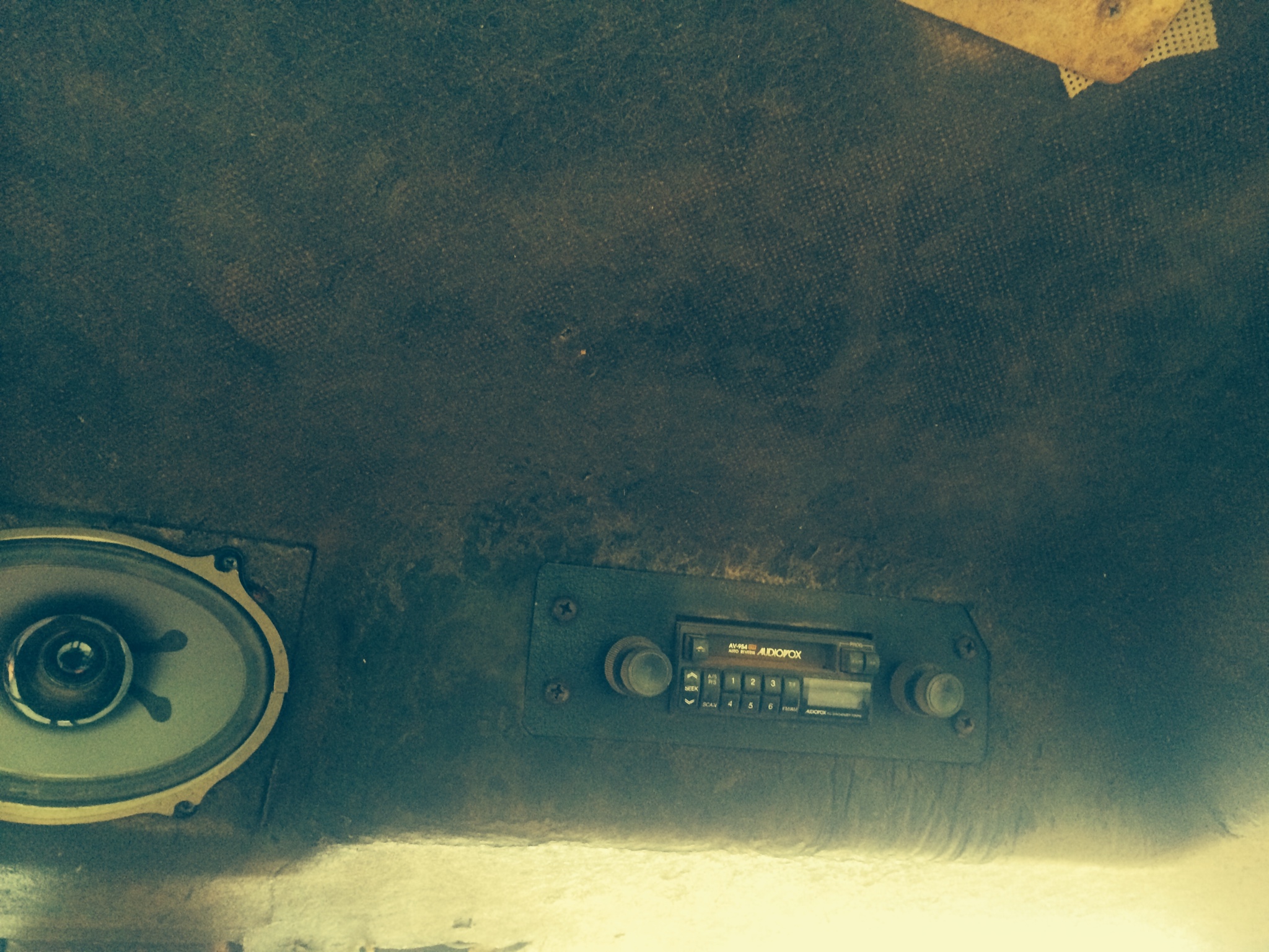

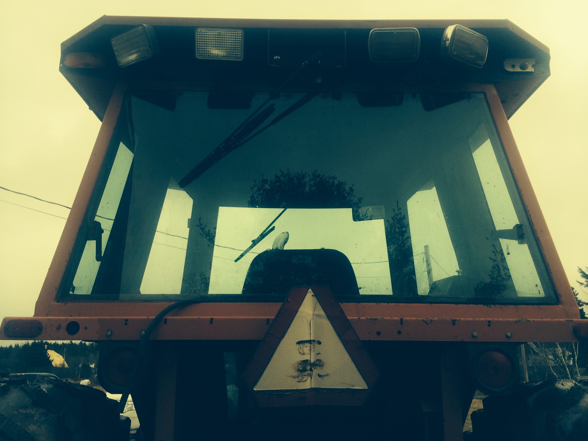

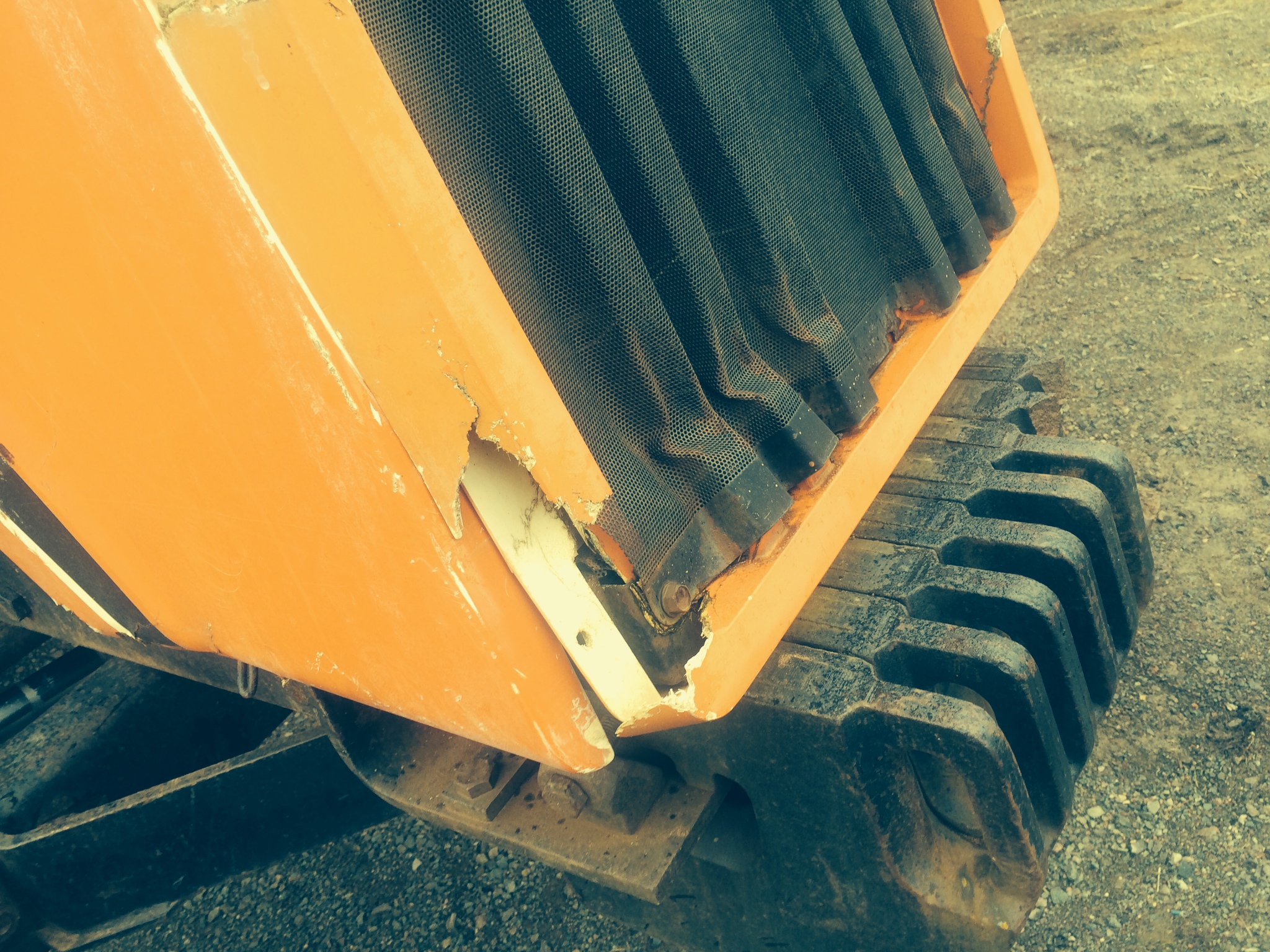

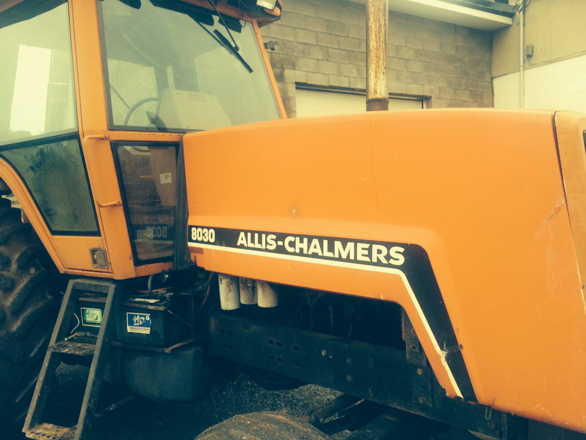

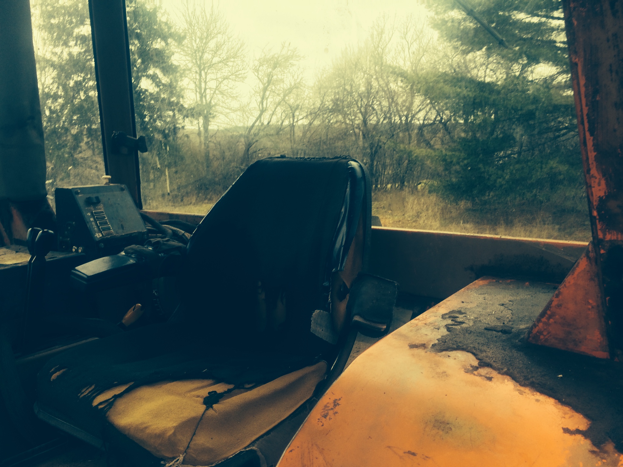

Some pics they sent:
Edited by slowzuki - 18 Dec 2014 at 9:57pm
Points: 21854
Post Options Post Options   Thanks (0) Thanks(0)   Quote DrAllis Quote  Post ReplyReply Direct Link To This Post Posted: 18 Dec 2014 at 10:04pm
That is the hardest used 2,000 hr tractor I've ever seen.....more like 10,000 hrs.

I would tend to agree about the hours being fishy, I do have a modern 4000 hour tractor that clocks straight hours that came from the same general geographical area off a dairy and it looks just as bad.
The jockey says the construction company foreman was at the auction bidding on stuff too answering questions and claimed the hours were correct, they owned it since new.  I can't tell but it looks like a baler control box or sander controls in the cab too which seems to poke holes in that story.
I'll check it over pretty closely, I don't need 15,000 lb of scrap sitting in my yard.

The dirt and grime on the leaking left rear axle is a dead give-away to me....that ain't 2,000 hrs.

I noticed the leak too, not good news that it would be left so long.  Nice they didn't pressure wash it spotless before selling.
Odd stuff too given how rough such as why the hydraulic coupler dust caps aren't broken yet?

Looked at it tonight:
-low range is very clacky noisy in transmission
-upper spindle bushings missing
-cab fan not working
-ac components removed
-ether system removed
-seat absolutely destroyed
-low hydraulic pressure light on when above idle
-exhaust flange seems to be broken off turbo
-filters all old
- no oil on rearmost dipstick with engine off
- forage harvester control box hard mounted in cab so lots of hours at wot
The good
No rust - amazing for a snowblower tractor
Engine starts well, idles well, responsive etc
Power shifts are smooth no slip in high range with brakes on
Brakes are very strong
Rad looks good
3 point works well
Drawbar hole not very worn
3 point balls still tight

Looks like a $2500 tractor to me. That is only if I had about $10k for contingencies. The cab alone will cost you close to $1k, the nose is ~$800, A/C components, all new fluids and filters, axle seal, etc......... and we have not touched the motor or radiator. If it does not have a coolant filter...... the list goes on and on

Eight hundred dollars for that shell around the grill?!?! I could fix that shell around the grill with $30.00 worth of fiberglass mat and West System epoxy, and with a coat of orange paint it would look like it did the day it left West Allis.
Pretty sure I could knock the dent out of that grill so it would look acceptable too!
