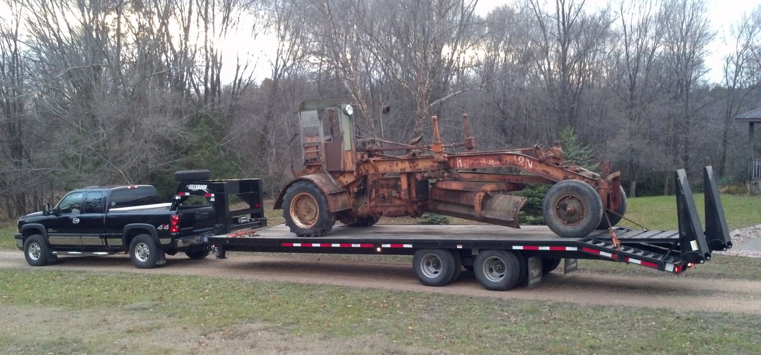

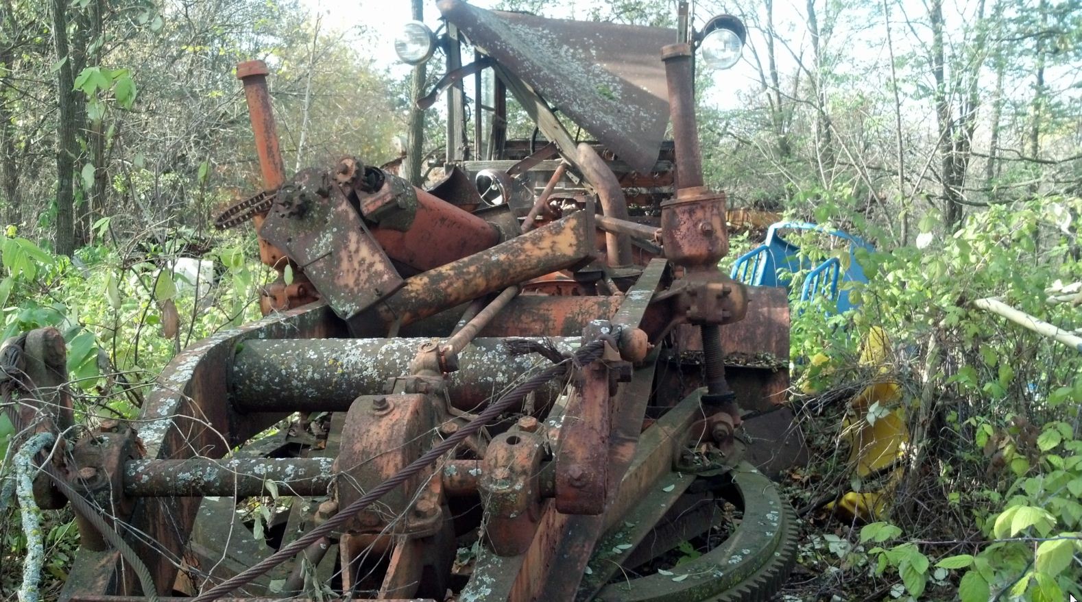

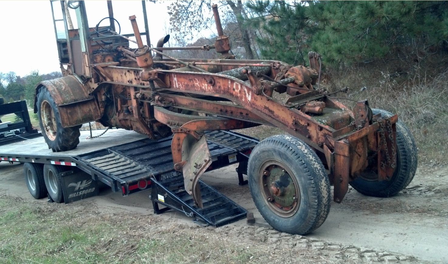

Hi guys-Here are some pictures of the 42S I have been working on.   Picked it up in November 2013.  She still isn't pretty but I hope to get it to the show.
Here is some background on it:
  • 1939
  • 42S is based on the UC tractor (same mechanicals engine back)
  • It appears that it had been sitting for 10+ years (based on tree growth around it).  Lucky for it, it was parked next to a nudist colony (I'm serious!  East Bethel, MN).
  • Front rims were shot...I ended up finding some 20" split rims to put on it.
  • Original rear rims were gone (it is suppose to have 24" duals similar to an on-highway truck of that era).  After much searching, I selected the same solution that the previous owner had...26" tractor rims.
  • The reason for parking it was that it dropped a valve in #1 cylinder and put a hole in the head.   These valves did not have a keeper ring on them that you see on many UM engines.
  • It was used for spreading asphalt at one time.  It's last use was clearing snow from parking lots.
  • The drives are all mechanical driven off the front of the engine...all this stuff was shelled out so someone had mounted a Briggs and Stratton engine near the main control box.
  • Left to do...get the canopy done and get all the actuators working.
  • Someone had painted "Happy Birthday Jan" on the side...several Allis friends have reported that they have used a picture of this to convince their wives that they are "normal"  ;-).
Enjoy the pics.
As found:
As I moved it:
Today:
