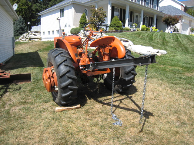

Could some one resend the specs,deminsions and picture of the lift crane I saw here mounths ago for WD and D series tractors?

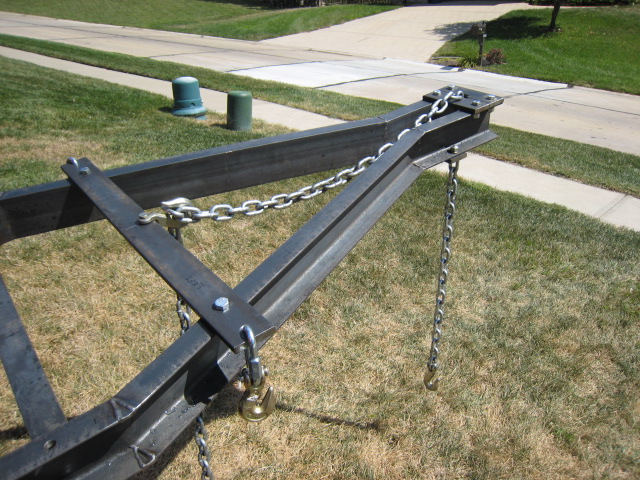

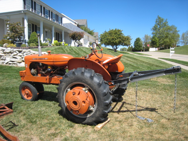

Bob,  Hope this is what you are looking for.  RickMuploads/298/IMG_3148.JPG

This is what I needed. Thanks is the channel iron shown in this 4", or 3" I can't read the fine print in the drawings?

Bob,  4" channel.  I forgot to mention that the one I built (in the pictures) is not exactly like the factory version which is what is shown in the Parts Manual drawing.  We made some changes to make it easier for us to fabricate.  So some of the parts and materials are different.  Here is a better copy of Material  List:
