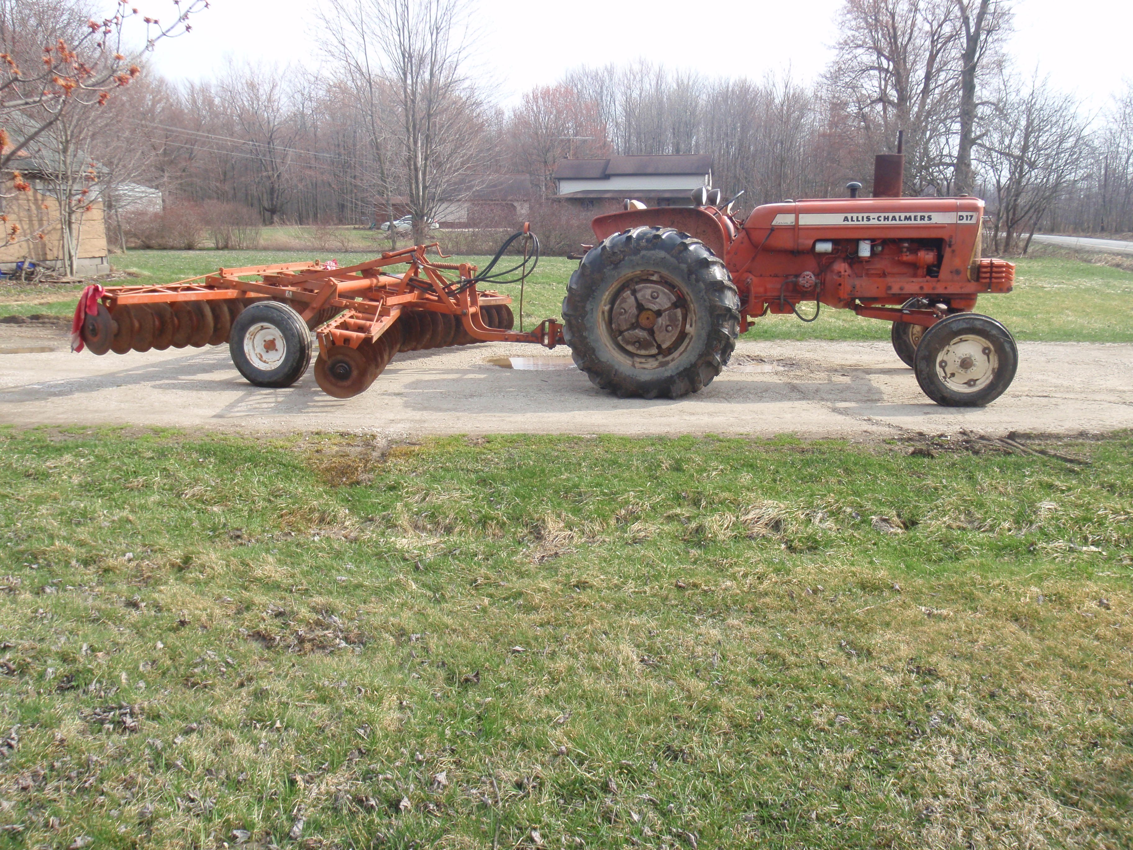

hootsandgiggles View Drop Down
Joined: 18 Dec 2013
Location: NW PA
Points: 69
Post Options Post Options   Thanks (0) Thanks(0)   Quote hootsandgiggles Quote  Post ReplyReply Direct Link To This Post Posted: 14 Apr 2014 at 1:49pm
Well, I bought the discs and brought them home on Saturday !!  The seller apparently did give them a "thorough going through" ...  all bearings and blades appear healthy ...  He told me and showed me where he had done work and replaced parts.  He had some original tools and a full extra set of disc scrapers that came with it.  Got it all for $850.  I am very happy and I can't wait for the fields to dry up around here so I can take them for a proper test drive !!  Thanks to those who chimed in on this thread with their opinions and advice Thumbs Up
Mike C.

Hey Hoots, I have a Series 4 17 with a 12 foot Allis disc that looks exactly like the one in your picture. I have an 8 foot piece of rail road rail on the back of it and the 17 pulls it like its an ertl toy.
Auntwayne View Drop Down
Joined: 23 Apr 2011
Location: Edwardsville Il
Points: 1589
Post Options Post Options   Thanks (0) Thanks(0)   Quote Auntwayne Quote  Post ReplyReply Direct Link To This Post Posted: 14 Apr 2014 at 8:55pm
   You did really good on the disc at that price , and , it looks
like you bought it from the type of person we would all like to
buy from ( somebody who took pride and care of their equipment ).
Best of luck .
