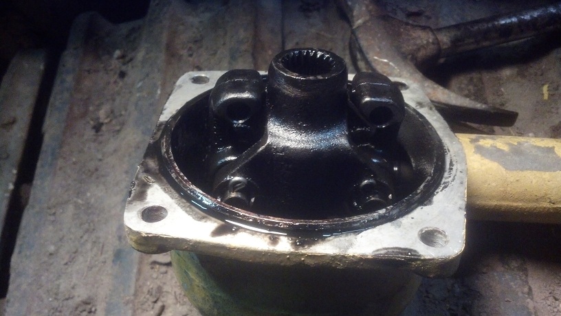

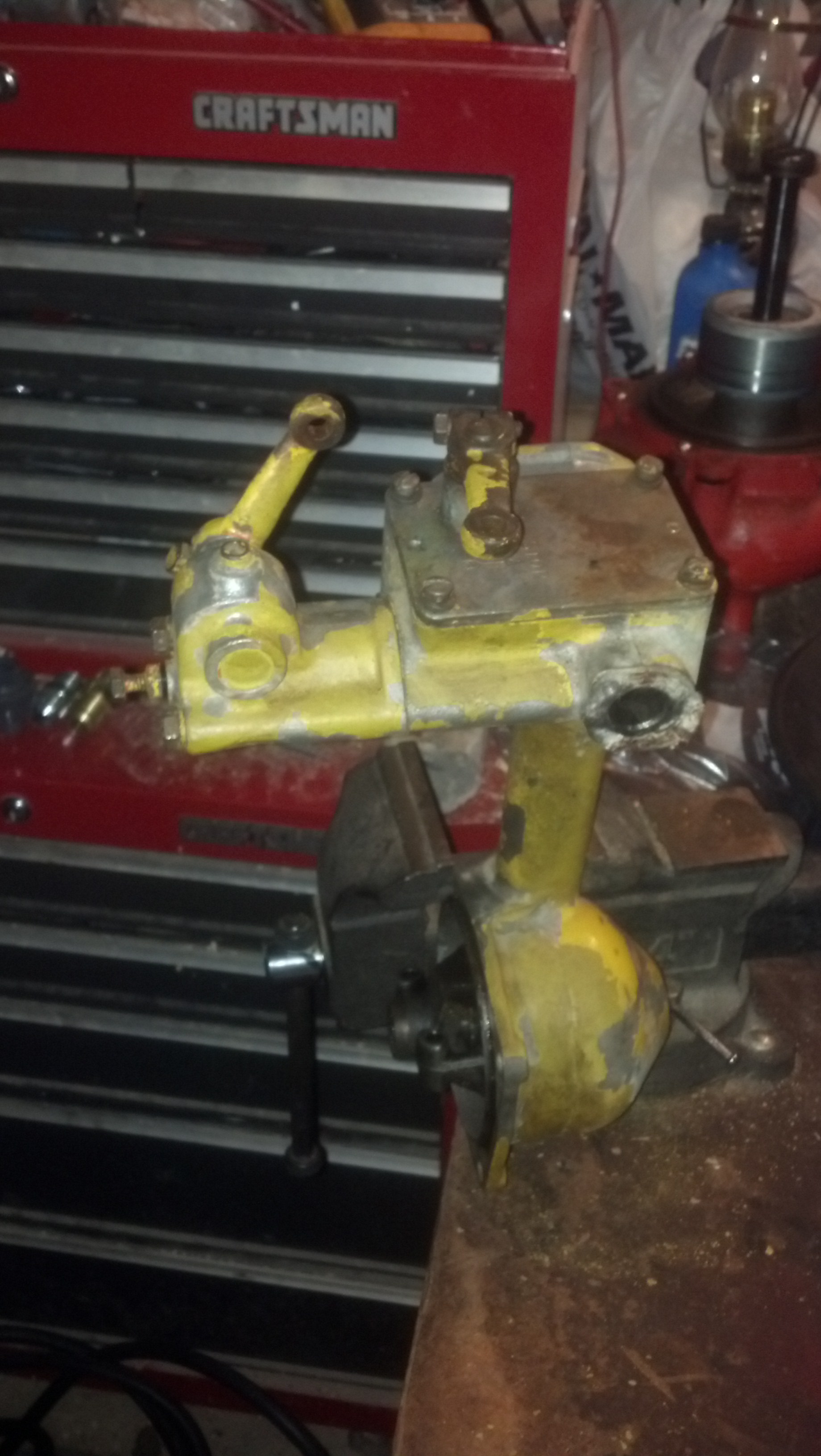

Took the governor out tonight. Only thing I noticed was that the fly weights dont move much at all. I would have expected more travel, at least enough outward swing to cause the little fork behind to move its linkage. I think I may have located the problem. But as I dont have any example as to the normal amount of movement Im at a loss. I didnt find any loose or missing parts inside. So any ideas?

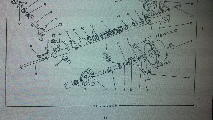

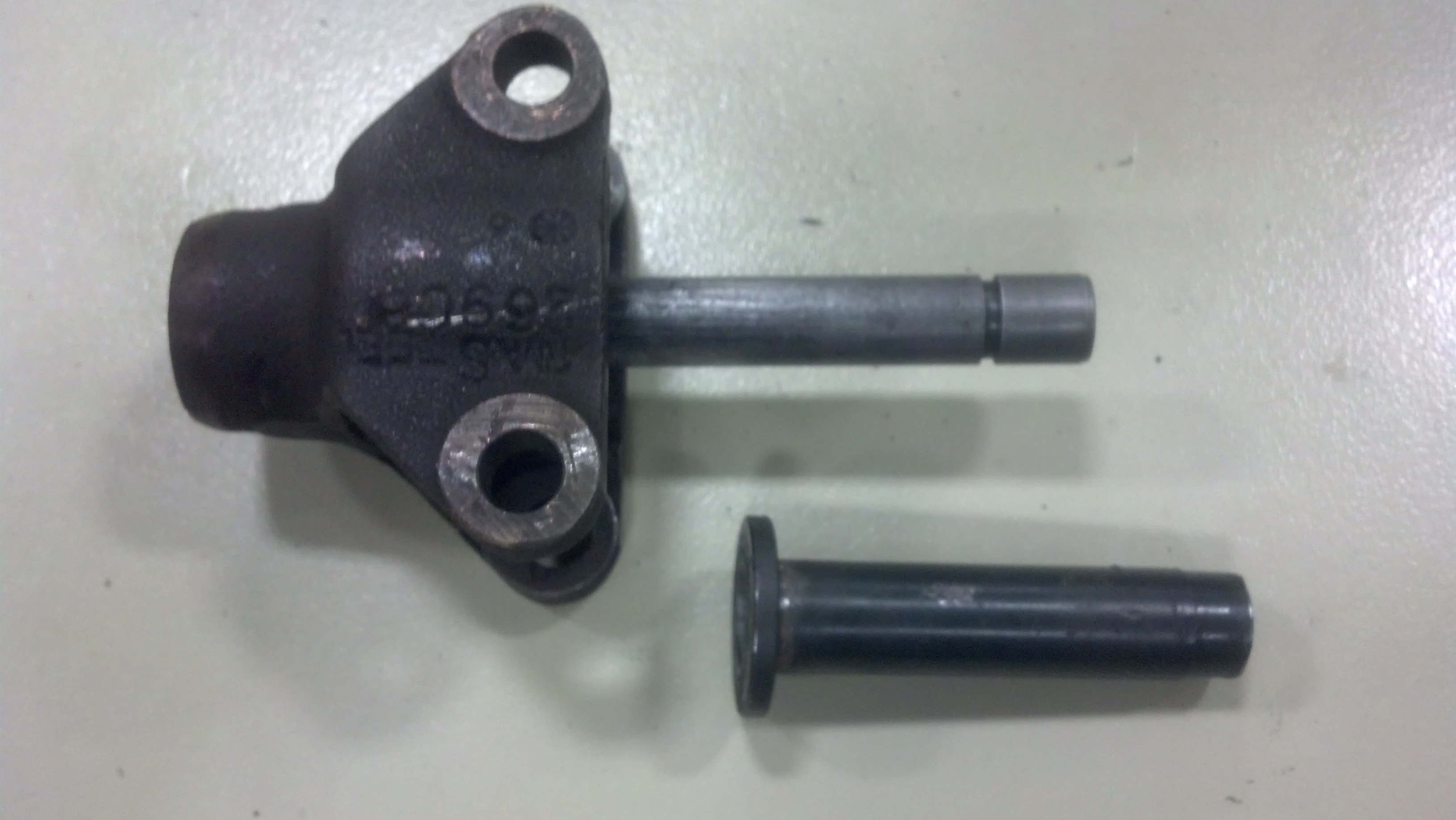

In the above diagram, the little tube #7 was frozen in place on #6 shaft. This is supposed to slide on the shaft to move the fork #21 and linkage as the weights swing in and out. I was suprised it was siezed up on the shaft as the whole thing was oil soaked inside the governor casing.
To free the tube #7 from shaft #6, I used a torch to heat up to a low red. when it cooled I was able to tap it off with a hammer and flat punch.
I will say that the whole thing is a pain to tear apart when its stuck as you cannot move parts into position to remove. I was able to not damage the casing which is aluminum.
The small bearing and washer on the end of #7 was broken on removal. I will have to come up with a replacement for that.

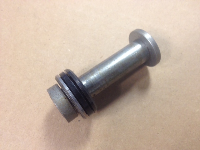

I found the problem was with a tube called the riser assembly. It was rusted stuck to the weighted shaft. Strange how it could get rusted even tho there was some oil in the governor housing casting. It was difficult to remove as the pieces were stuck together but I managed to do so. A propane torch heated up the tube and I was able to remove it. After cleaning all the parts, inspection and lubrication, I was able to reassemble the governor.
I was able to move the fly weights and observe the linkage movement. I will install it back on the engine and follow the manual to set spring tension and linkage.

I was able to put the original riser tube assembly back together. But I did look around on the internet to see  price and availbility on a replacement. Part# 5155571. For Detroit diesel 2-71 engines with variable speed governors. I found about 6 sources for anything from custom built to new old stock part. From as low as $65 NOS to as high as $198 built !!.
