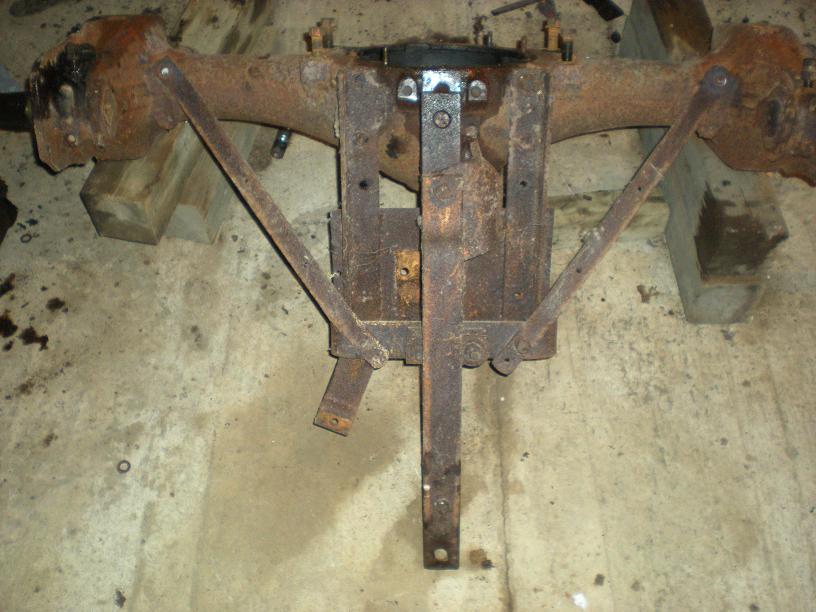

Post Options Post Options   Thanks (0) Thanks(0)   Quote Redwood Quote  Post ReplyReply Direct Link To This Post Posted: 05 Oct 2012 at 9:42pm
Here is how it looked this morning.  It got too damp to take any more soybeans off so started at it.  the brace bolts (not OEM) both snapped,  the to bolts on the right snapped. and the one on the left is welded in place.  Nothin is going to go easy with this. It is hard to see in the photo be the brace on the left is welded to the cast.  Only thin left to dismantel is the weld. I hope to cut it off tomorrow.  I wish I could get it into the drill press.  But even I a could I wouldn't know where to get a slowspeed bit (old cast belt drive)  That would be perfect.  I cant go the bolt on way all holes have something in them.  I makeshift magnetic drill bushing might just work (drill guide)
We will se how it goes

Post Options Post Options   Thanks (0) Thanks(0)   Quote Tracy Martin TN Quote  Post ReplyReply Direct Link To This Post Posted: 05 Oct 2012 at 11:02pm
If you had a better rear end, I would just use it. Change your serial number to the one you are replacing. Probably be better off in the long run. Tracy Martin
Redwood View Drop Down
Joined: 16 Jan 2012
Location: Ontario
Points: 631
Post Options Post Options   Thanks (0) Thanks(0)   Quote Redwood Quote  Post ReplyReply Direct Link To This Post Posted: 06 Oct 2012 at 8:35am
Tracy  yah that would make sense.  I but if this was about sense I wouldn't be looking into putting a few thousand into a tractor that will never be worth more then its weight in scrap  lol.
Other then the bolt issue the rear is in exellent shape dispite the looks in the photo.  The drawbar itselkf is the worst thing on the tractor.  the guts of the rear end is in real good shape.  I may replace the gears on the final drive shaft as there is some wear but they are not bad.
As for changing the serial number I'm the only one that cares about which serial number it is and changing the number won't fool me.
Given the condition it will be in fine shape once its redrilled.  I'm looking into the helical fixes to see if they are stronger but if not I have no problem with oversized bolts.
But you are right about the better solution
