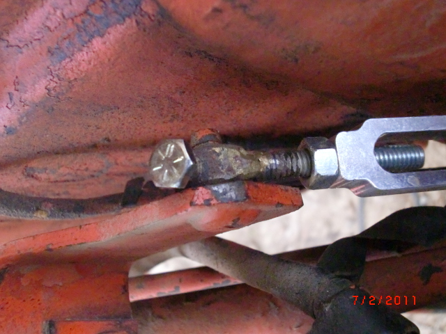

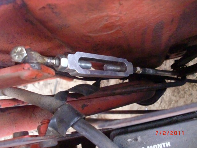

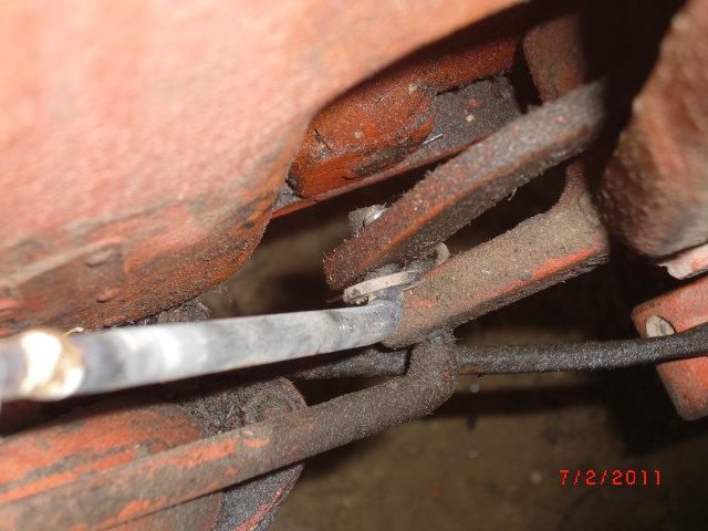

My fix for the jumping sliding collar lever. I have no desire to rotate it by hand, it is easier to rotate the PTO shaft of the equipment.
Top, pivot point for the manual lever.
Bottom, the collar lever.
Complete view.
This keeps the lever in the locked position at all times. I made the turn buckle setup because it was easier to get the correct tension on it. Not loose, not too tight.
