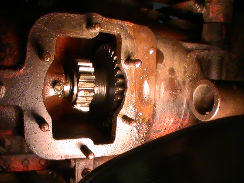

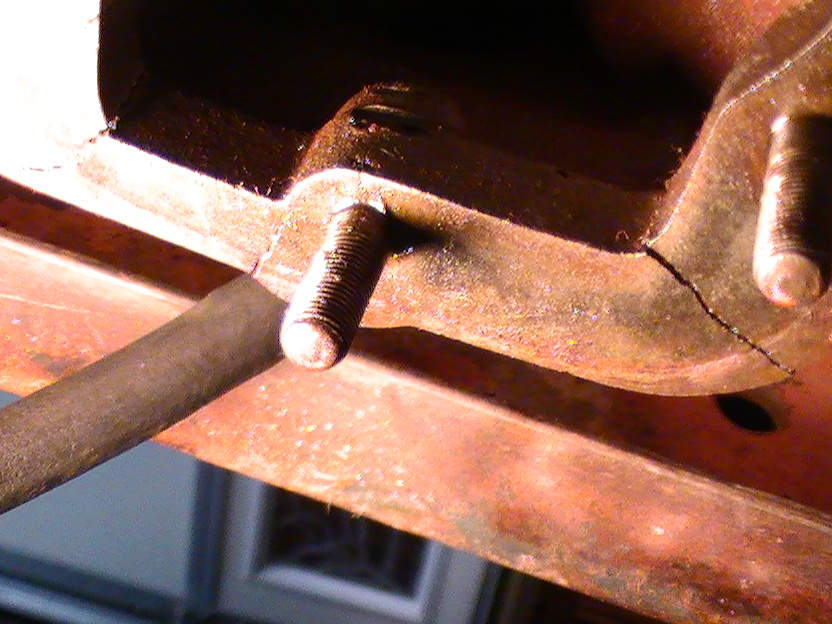

 I was cleaning the part of the torque tube where the PTO bolts to it underneath. I am having to replace the PTO assembly because it was broken by the fellow I got this tractor from while he was brush-hogging. I just noticed two slight cracks in the torque tube housing that are about 2 inches on each side of 1 bolt. The cracks go up into the housing about 1 to 2 inches and I believe they either connect or at least go toward each other. The rest of the bolts on the housing and torque tube are fine.
    My questions are these. 1. Are these slight cracks enough of a problem that I should replace the torque tube now?  2. Will the PTO housing just snap off again when I start up the PTO and engage a brushhog? 3. Will tightening the bolt down on the PTO housing cause this part of the torque tube to snap off? 4. Is this something that can be welded or fixed with a JB Weld type of product?
    Thanks for any suggestions or comments you guys might have.

 Replace it, they are plentiful,  and cheap.  Buy one close enuf to drive to pickup.

you will need to disassemble it to replace your intermediate gear anyway, just replace the whole works

Replace the housing.

Yes I agree - replace the housing, I had one in my junk pile that had the same brake and
had been welded and broke again -- get rid of it now and be done with it!!

     Everbody is right!  You have to take it apart anyways to replace the gear.  If you don't replace the housing it'll either break or you'll constantly worry about it breaking.

Thanks to everyone for all the replies. I just knew I was going to have to replace the housing. I wanted someone to tell me what I was afraid of. I know your all right and I am going to bit the bullet and break the tractor and replace the torque tube. Rick I PM'd you back. Thanks again to all you guys. Your really great to help me out.
