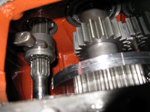

As mentioned in earlier posts, my pto fails to engage when I lift the clutch. Attached is my PTO clutch assembly. I took the side plate off and this is what you see. The dual spline seems to slide fine from the split splines. Should the front shaft turn freely by hand when engine not running? Appears the issue may be further up into the transmission. Would it help to start the engine and see if the front shaft turns?

As long as the splines seem ok on the two shafts and the collar then I would look in the hole you have open and have some one turn the engine over with the starter to see if the shaft turns.  You may have  a problem with the pto clutch itself.  I have never had a problem with one on a 6060 but have fixed other makes and models with broken rivets and discs.

With hand lever on right forward you should not be able to turn the shaft going forward from couppler.
 See if the cross shaft from pto hand clutch is turning where it goes through housing. Have saw them bind in housing to where they will not let the throw out bearing move.   MACK
